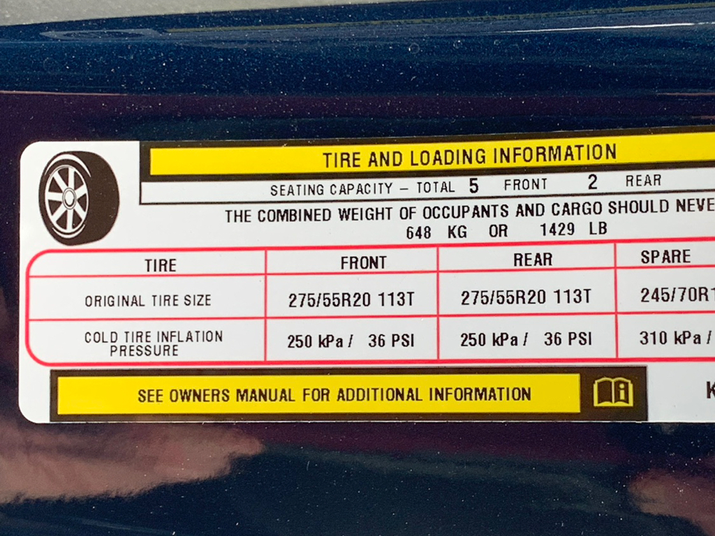

Here's mine. Just picked it up this week with 6,500 miles. Loving this forum.
Limited 4x4 with Air Suspension. #1429

A salesman is trying to tell me that the sticker on the inside of door is generic and the actual number to trust is the report they run off by the VIN. The payload number on the sticker is about 400 pounds less than the report. What he is telling me is obviously not correct?
Tr
Trust the sticker inside the door. It has been verified by several members here by weighing their truck. DO NOT trust the salesman!
Yea, he’s an idiot. Ask him to run 3 different vins on the lot...
Tr
Look at the sticker and the truck registration weight if your frame supports 7100 lbs - truck actual truck weight on a scale 5033 = 2067 and on my sticker it says 1857 so my real payload is 2067 pounds
