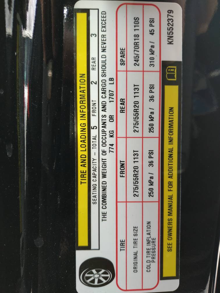

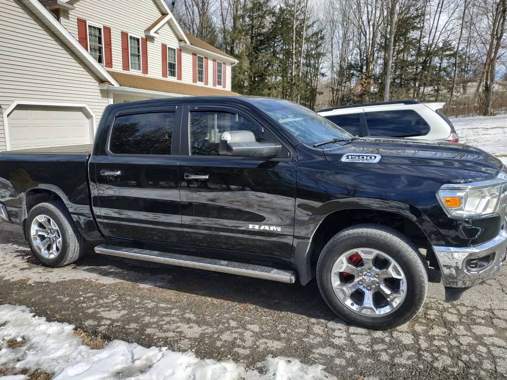

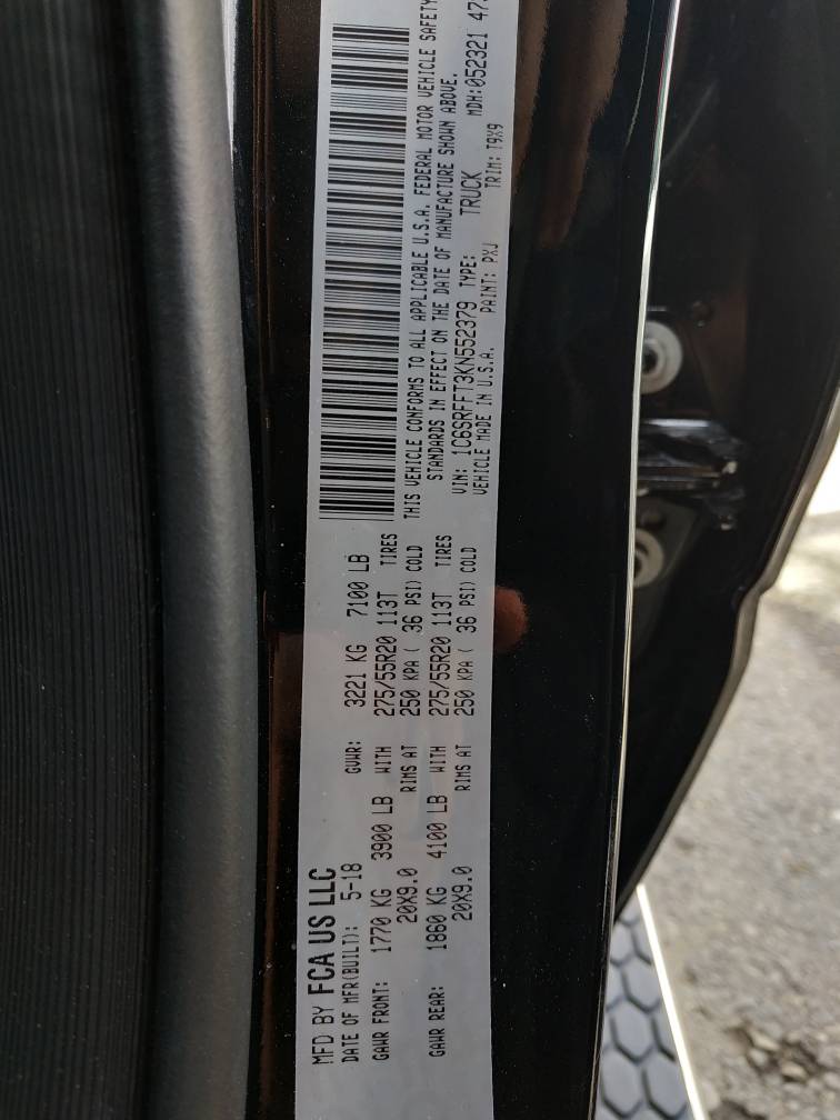

Disappointing numbers - 1220#
2019 RAM 1500 Laramie Sport, 5.7 (non-eTorque), Off-road, no RamBoxes, no cover. Bought to tow a 27’ Airstream Globetrotter with 1000# tongue wt., 6600# dry, 7600 max. Leaves just enough for me and the dog. Haven’t told the wife she’s not going yet due to cargo capacity:-)AC951361-141E-4EF5-B0B5-0367E2891064.jpeg9D69A8DE-78FB-4F4D-8AC4-DE4AFB9A2575.jpeg3E22463B-9B21-4225-B27B-C9C7E4C01801.jpeg

2019 Laramie crew, 5.7 e-torque, 20 inch wheels, 4x4, 5-7 bed, bed group, yellow payload sticker 1556lbs, white vin sticker 7100GVWR. no sunroof, skid plates
