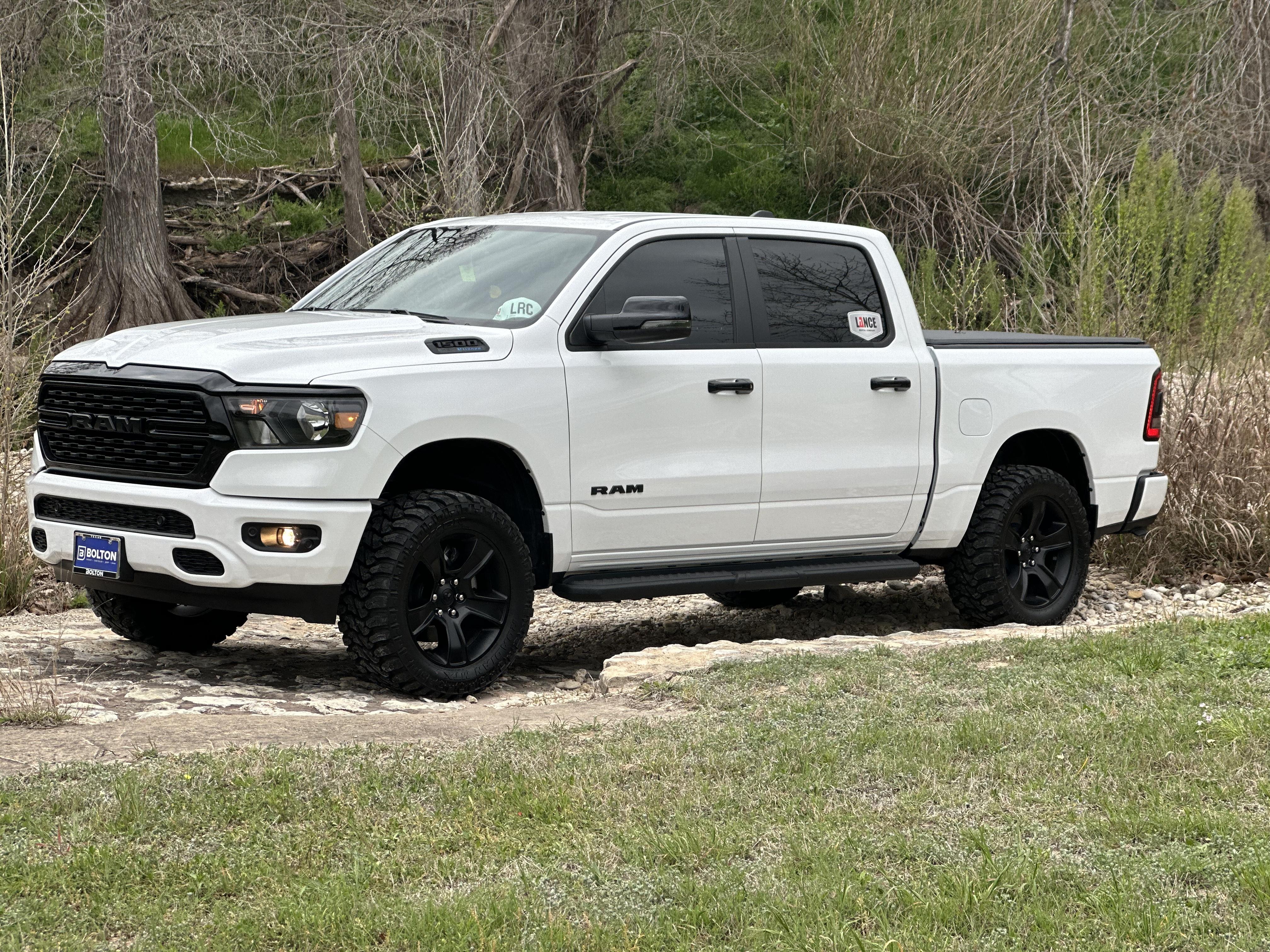

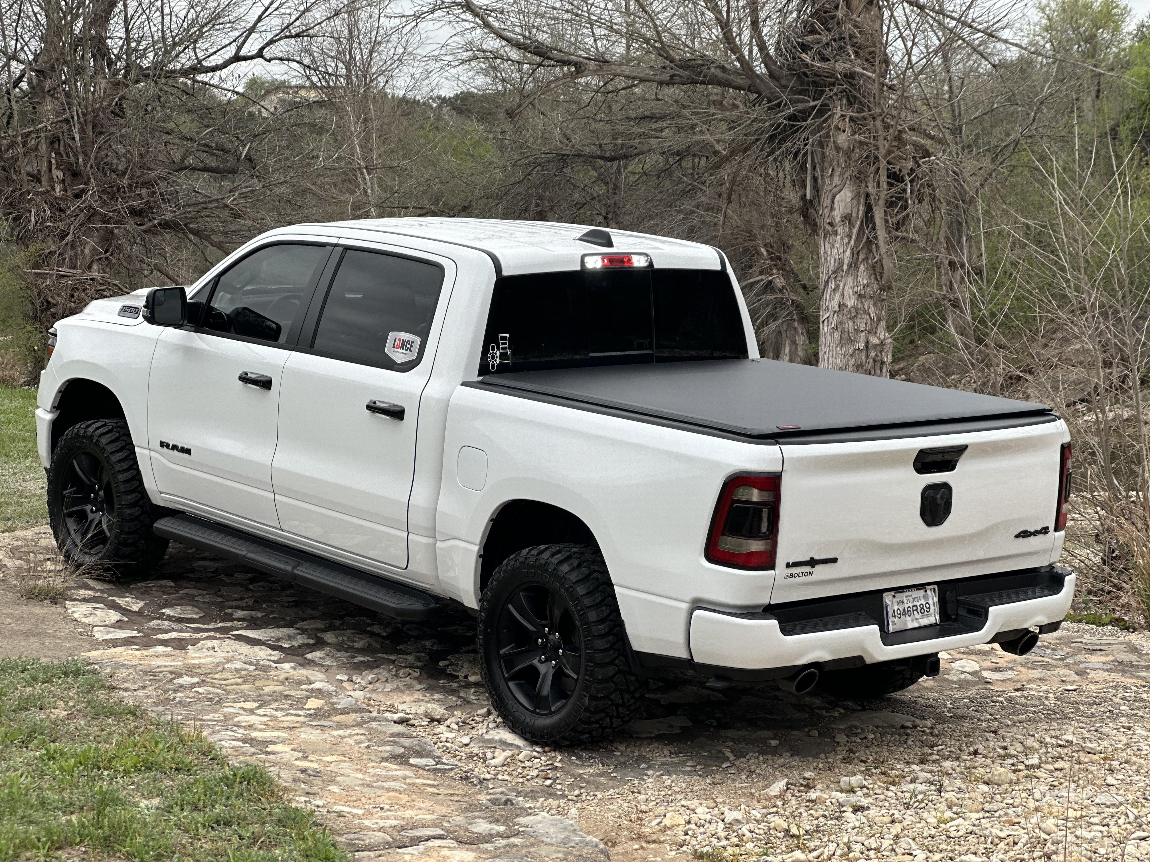

Been a minute since last updating mine within this thread. Figured I should do so.
ReadyLIFT 3.5” SST
Yokohama Geolandar G003 MT
315/70/18 (35.6”x12.4”)
Black Rhino Rapid Wheels
18”x9.5” -18mm offset

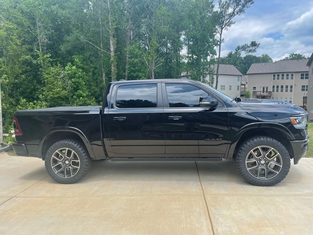

Mines the lifted one 3.5 rough country with 35 12.50 18 Lon the stock wheels both 2020
Second pic one on. Right is lowered 2”
Mine has some heavy duty springs in it now so lost my level them stock ones can’t handle weight

readylift 3.5 " with nitto trail grapplers 35x11.50 with 20" fuel titan wheels 20x10 with -18 mm offset. The tires did scrub at full lock but i heated the plastic wheel liners up and pushed them away from the tires and they dont scrub. Im overall happy with the looks and the quality of the lift.
