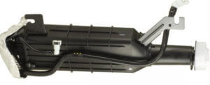

I got my truck back and have filled up twice without issue. The dealership said they replaced the ESIM. That is the only part that is noted on the work receipt except the fuel they added for their tests.
I got under the truck to look around when I got it back... I could swear the gas tank looks new. The factory white stickers are still on it without a stain! I can't imagine those held up 15k miles in MN winter and dirt roads + many car washes with under carriage blasts in the condition they are now. Maybe they replaced the tank and didn't say? I think a single car wash might take those stickers off. Anyway, maybe they only replaced the ESIM, maybe they did more. They had my truck for 6 days claiming a wait on the ESIM.
Considering how cheap the ESIM part is and relatively easy to get to, it might be a good starting point for those out of warranty. Fingers crossed this one goes further than 10k miles which is about where the first one began having issues.

The evap module prevented fueling? How does that work? Maybe they did put in a few tank?

I am not really certain yet, I'll try to get under the truck again when I have time. It seems it could be the ESIM only, it has a weight that moves tied to a plenum of some sort acting as a check valve. It could in theory block flow to the canister from my understanding of it. From the page below:
"During fill-up, vapor pressure from the tank pushes the heavier yellow weight off its seal and gas vapor flows into the charcoal canister. The pressure also pushes the diaphragm away from the electrical contacts. The ESIM contacts receives a reference voltage from the PCM and the PCM monitors voltage drop. When the system is under pressure and the diaphragm is pushed away, the contacts aren’t closed so the PCM sees no voltage drop."

А теперь по поводу заправки пишу как и обещал. Сегодня заехал опять на заправку где не смог заправится до продувки всех трубок и обратного клапана. Пистолет заправщика включил на полную мощность. Заправка прошла до отсечки ( первого щелчка) без остановки. Думаю что продувка через угольную коробку каким то образом даёт барану заправляться без проблем. Это лишь мои предположения но это пока помогает.

После продувки через бак и угольный фильтр заправился очень быстро и без остановки
