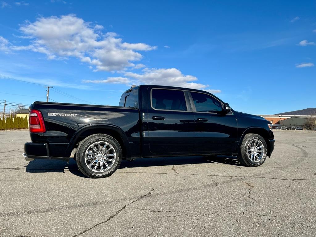

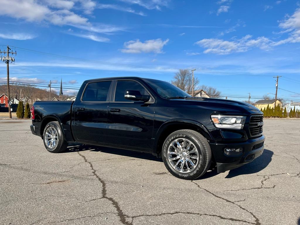

My Maxtrac lowering installation
Start to finish I was at 4hrs. Including drinking my coffee, unboxing everything, and trying to stay warm, (it was 20*f this morning)

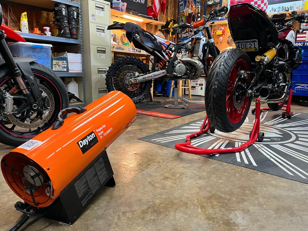

A long time ago, I bought the big buddy ceramic propane heater. It got my 350sqft garage (8ft ceiling) from 40’s to high 60’s in 15mins. It doesn’t work nearly as well in my new garage with 14ft ceilings, but if I put it a couple feet from me, I’ll be sweating.
I have one of these that works quite well. It took the chill off enough to where I couldn’t see my breath.

Also zero vibration at sustained speeds near the limiter.
The ride has changed, I went down to 10psi in the bags. But I think it’s the valving of the shocks, as a previously lifted truck I had 5100s rode the same. It’s “firm” but controlled. Which is what I wanted. No more floaty squishy suspension over bumps.
So far I’m happy. Hopefully my alignment will be in the green
She settled another .25in front and rear after two days of driving.
Original post updated with alignment specs. I’m happy with it. And drives straight
Did they max out the camber adjustment?
He said he got it as good as he could.
