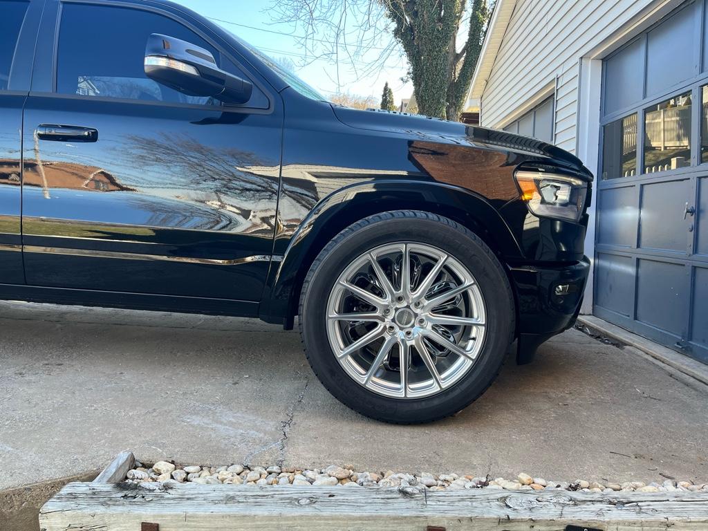

Man, that makes me want to lower mine. How's the ride quality?
DO IT!!!!
These Rams are awesome lowered.

Is the ride quality the same or better? That's the only thing I don't want to suffer. They look great lowered.DO IT!!!!
Report back when you get a few road miles on it. I’d like to know how it rides and handles.Better? No, same, kinda.
The 5100s give a more controlled ride. Less squishy than the Oem shocks.
I have about 700 miles on my 2/4 kit. I love it. Driving around you can hardly tell it’s lowered. It drives great and handles perfect. I think the bilsteins really made all of the difference.Report back when you get a few road miles on it. I’d like to know how it rides and handles.
