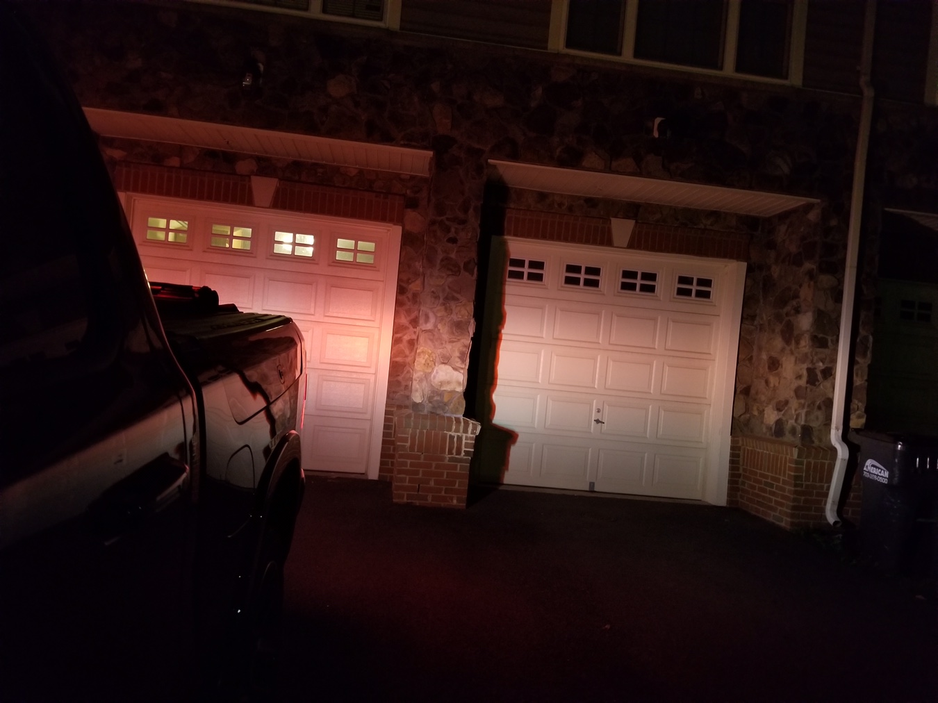

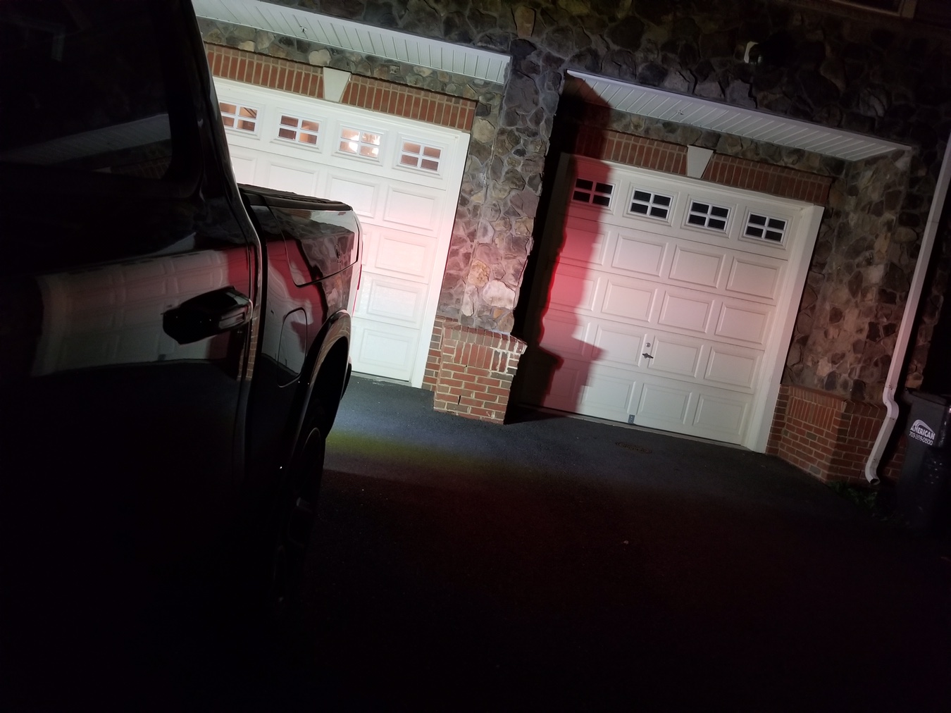

I sat at the end of my driveway and stuck my phone out the window to take pictures of behind me. One with a thick blanket over the LPR light.
I’d say the LPR light kicks major ***.
