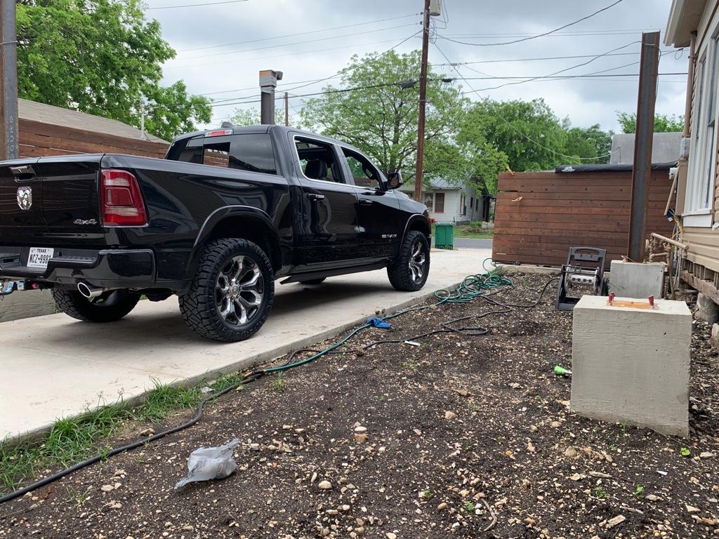

On nitto grapplers Lt325/50r22. No problem with the height but the width rubs and ripped off my height suspension link on almost full inside turn. Need spacers.
Yes...you most certainly do...325 is CRAZY wide! Did your tire shop not tell you this was too large a tire for your truck or do a test fit?
Bro you have to calm down. I’m not running 305s, I'm running 285s.. I never said run that tire. You have me confused with some else short fry. You been told exactly what is what. Thread over. Love it and weep
Are these 285/55 Terra Grapplers?
Ridge Grapplers. If you call Nitto, and most all ire shops, they will tell you the Terra Grappler is WAY outdated technology and doesn't perform anywhere near that of the Ridge Grappler. However, the Terra G2 is a cheaper alternative but at what overall cost in performance?
@Fatboy is that pic your truck, looks awesome. What size are those tires 285/55? Are those Terra Grappler G2s?
