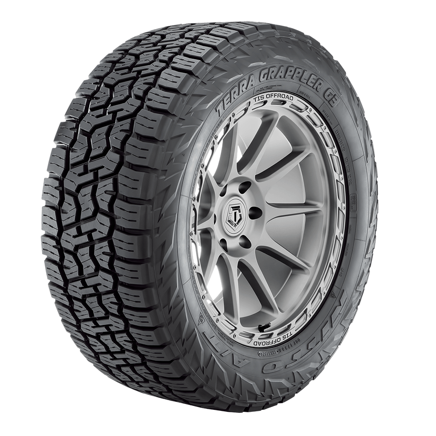

Again, these are 33x12.5R22 Nitto Terra Grappler's. I had the OEM wheels powder coated in "ink" colored polished black.
I have plans to add 2 inch spacers and a 2 inch leveling kit.

I put 33" x 12.5R22 Nitto Terra Grappler G2's on my 2019 Limited with Air Suspension and have zero rubbing issues with no lift or leveling. See picture in my avatar.
Are the tires loud on the highway?
Its a firmer ride for sure. if you’re trying to keep the stock luxury ride dont go too big. If you can stay away from the 10 ply the ride would be closer to stock. I love the way they look but if I could do it over I’d get the Nitto 420V’s to keep that luxurious ride
I like the Nitto 420V but the mileage is kinda crappy also since my tires are already in the yellow at a little over 13 months. I do tow really heavy and have 19K on them...
