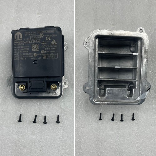

Hey any of you guys who have modified your own LED tail lights to fit the sensors.... any one got a part number specifically for the Drivers side heat sink only??
The 2 sensors i ordered that came with a little harness on them were both passenger side ones. :rolleyes:
I know the blind spot sensors themselves are the same on both sides so i'll just keep these if i can find the driver's side heat sink.
All i can find for it anywhere is this number: 68396592AA But the stupid description lists it as LEFT and then says RIGHT below it but i know these are not the same. Thanks for any help.

Edit: I have the same issue. My parts guy told me and swears that it only calls for one number. When I tried to do a little digging with him, he showed me part numbers that are different than the tail lights I have. I’m not sure that that means anything though. what I’m contemplating is if I should trim two ears off of the heat sink to fit it on the left tail light.
@Jimmy07 do you have any insight into this issue? The pics below show the difference in bolt pattern and last pic is what it should look like. Passenger side fits fine, like I’d expect.
It’s weird. When you drill down that far in parts it starts to get dicey for accurate numbers.
But your pics answer my question, it’s def the passenger one. I was actually hoping there was an off chance that when you buy a heat sink, you get both, hence the weird right/left description and the 1 part number. But I guess no such luck.
Idk if trimming off 2 ears would be good tho since that’s half the contact points that hold it in, unless you could drill 2 new ones and make sure the screws didn’t penetrate any electronics inside the light. But it looks shallow and busy in there
I’m about to cut mine possibly this weekend, so we’ll see how that goes. Gotta really figure out the best but to use since just saying “I Dremeled it” doesn’t really give a method, bit type and what to look out for. But in this thread you can see that the electronics are very close to the part we have to cut.

After spending a bunch of time with my parts guy, I’m beginning to think I’d need to buy the entire tailight to get the heat sink. If I can’t find the correct one (which I have near-zero faith in finding), I’ll trim the two ears and use speed nuts with tiny bolts. Probably something close to 8-32 x 3/8 bolts. I’m amazed no one else has run into this besides you and me.
Yeah it’s kinda crazy. I was considering the same thing, but that’s a big price tag. Plus I wasn’t sure how much luck I’d have getting rid of the old ones afterward.
Have you checked eBay? There were still a bunch of sensors with heat sinks on there. We must have just been late to the party.
I bit the bullet and bought one I made sure was drivers side and I plan to just relist my extra one once I have this all installed and working. Sucks tho cuz the 2 passenger side heat sinks I have are ok and the one drivers side I ended up with looks like was in WWII.
Let us know how modifying it works if you try that tho.

This is the one. I grit my teeth and bought.
Interesting tho, these pics are new, and he says there’s one left. This heat sink looks clean compared to mine AND this sensor is an AE… mine was an AD (but I already have 2 AE’s so I’m just using those)

Thanks for posting that. I decided that I’m tired of spending money, so I’m doing the ol’ snip snip on the RH heat sink. I’ll post pics when I do it.
No prob. Pretty curious to see how that works out.
Consider modifying the plastic vs cutting the heat sink tabs. It looks like you should be able to melt/cut a semi-circle for the bottom mount pretty easy. You might even be able to screw in the one tab that will be sticking out.
Just a note of caution tho, if you start putting screws into the housing where they aren’t planned for, just make sure you know what’s behind that plastic and how far the screw will protrude. These LED housings have a lot more to them than the old halogen style ones.
