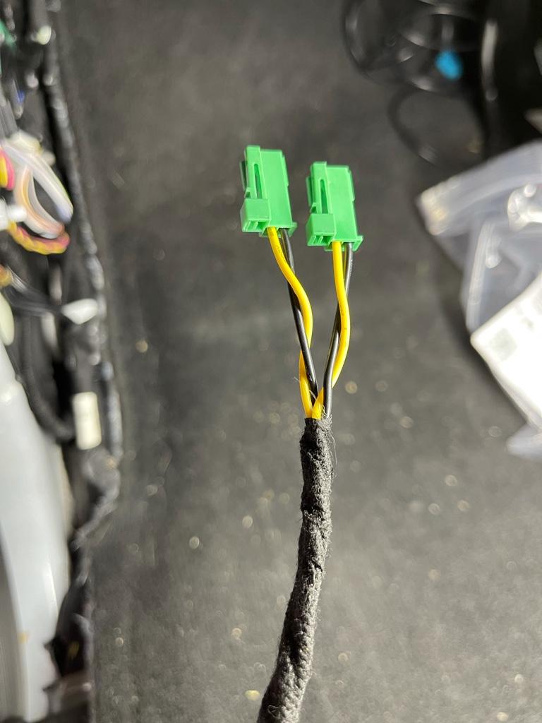

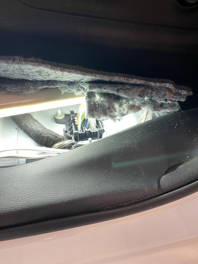

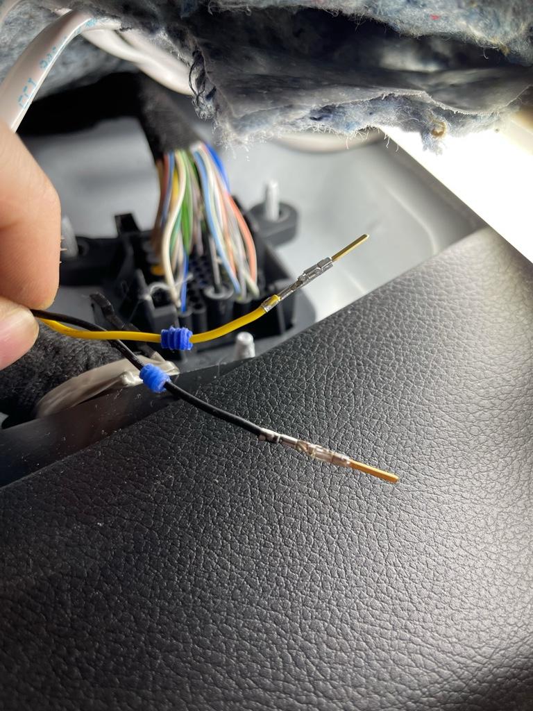

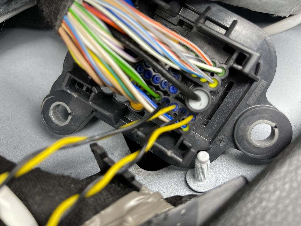

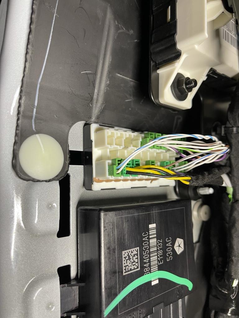

I’ll chime in. I did not drill a hole in the floor. Don’t like that idea. Here are some pics when I did mine.
