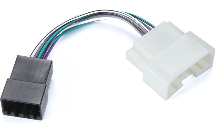

I successfully purchased a bypass cable and disabled the ANCIMG_20200826_074039.jpg
