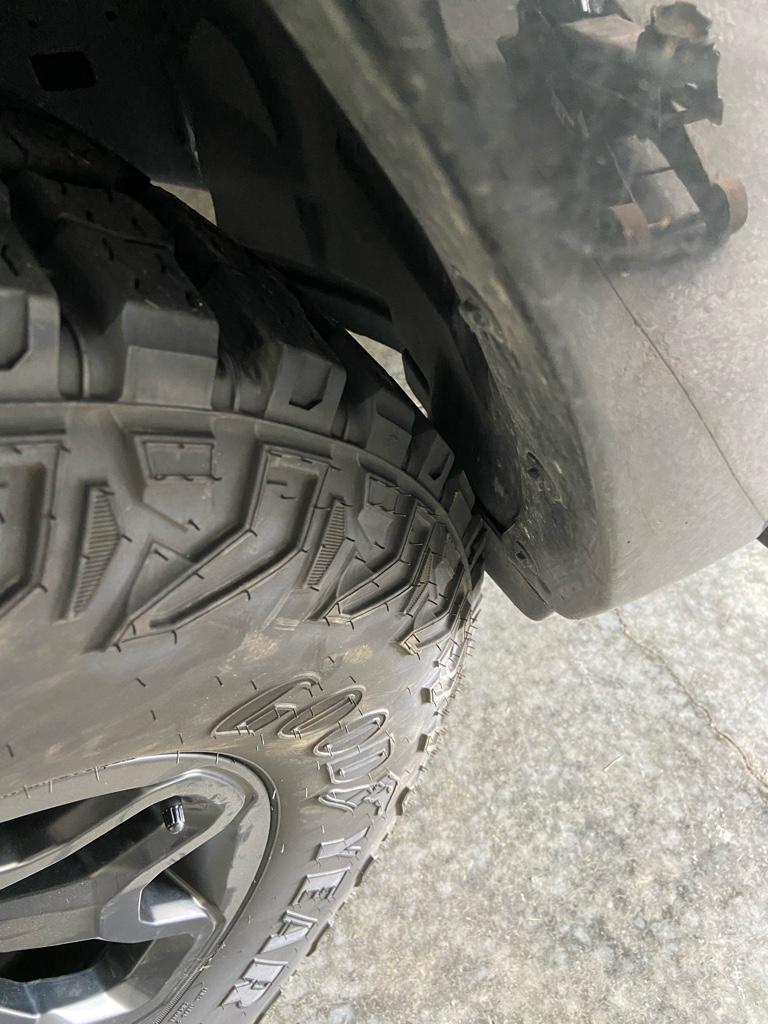

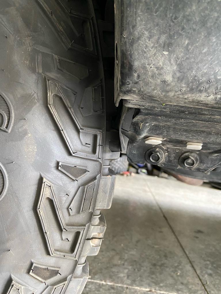

Picked up a set of TRX wheels today and going through fitment issues right now. Curious if anyone has a similar setup. I may be able to resolve by grinding off some metal tabs and plastic mods behind the wheel, but might be better off ordering and awaiting smaller wheel spacers.
My setup:
Laramie with ORP (rebel height)
Leveled front with Bilstein 5100s in #4 clip
Wheel spacers are 2” (I now recall changing from 1.5” to 2”)
Current situation:
Put front TRX wheel on and have a very small rub on front wheel well liner. Massive interference with back little plastic mud guard. Pulled the guard and have very small clearance to plastic fender flare, interference with metal tab, and wheel liner.
I’m sure I can modify the interferences, but would I completely resolve interference issues with a 1.5” wheel spacer instead?

My opinion: Measure 1/4” in and see where it contacts. I say 1/4” because with the weight of you behind the wheel, the left side will sag a little more. That should let you know if the 1.5” spacer will work. Or put someone heavy in the driver’s seat when you have a full tank of gas and measure how far in on the tire would not make contact.

That’s what I have on my truck. The TRX tire is bigger then a 35x12.5, but that size will fit fine with a 2” strut spacer or a new coilover. The amount of people that can’t figure this out blows my mind. I’ve blasted this all over the forum and you guys still don’t believe it.
The TRX tire is 34.6” to your 35”, and 12.8” width to your 12.5”… so I’m 0.15” wider per side with my clearance problem, but smaller diameter so it’s very close to even match. Buying 35x12.5s isn’t solving the issue I have.
I already have over 3” of lift, so I’m beyond the 2” you’ve recommended.
My problem is with my wheel spacers at 2”, which makes my turn radius larger and is definitely contributing in a major way to my clearance issue. I ordered some 1.5” spacers that will be here tomorrow and I’ll try them on for fit to make sure it resolves my issue before I go to cutting on the truck any further.
Eltaco
Feb 9, 2020
597
632
Take the wheel spacers off then.
To be honest I didn’t even try that since there are plenty of pics above of people showing UCA interference with no wheel spacers and TRX tires.
I’ll report back tomorrow after test fitting with the 1.5” spacers.

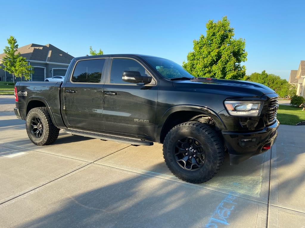

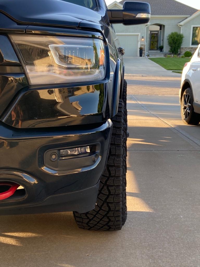

Got it up and running today. Specs as follows:
Ram 1500 Laramie ORP (+1”)
Front leveled (+2”)
Wheel spacers: 1.5” front, 2” back
Removed front mud flaps
Pulled front wheel liners in with zip ties
Ram TRX factory wheels and 325/65/18 tires

Did the 1.5” spacer resolve ur issue of hitting the inner fender well and metal tab? I have 2” spacers and want to try 1.5 wheel spacers to see if it’ll stop the clearance issue.
Yes, I run 1.5" spacers with no issues. There is nothing even close to rubbing in the front.
