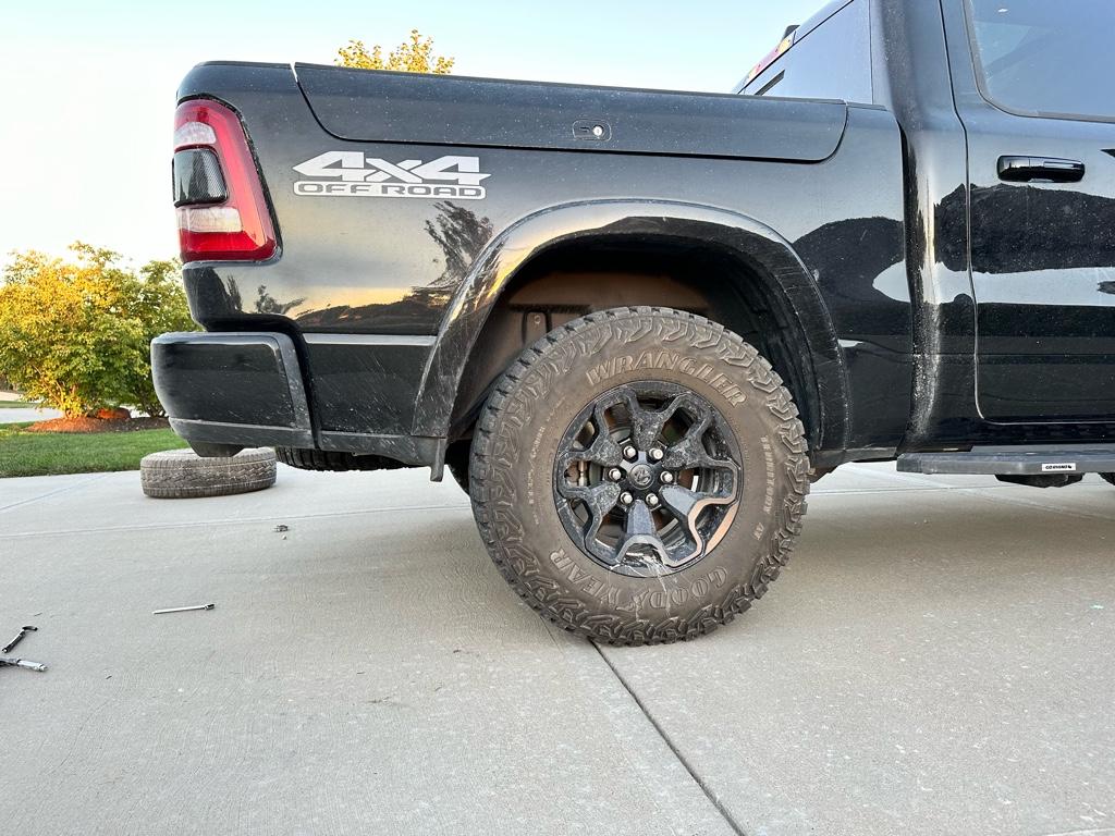

I got some TRX take offs on my Rebel
View attachment 152247View attachment 152248Father son project complete. I ended up using 1.5 spacers with some minor trimming. No rub.
Looks great! Would you mind posting some more pics from different angles? I'm installing the same tires/wheels on my rebel but idk if the 1.5 spacer has too much poke. I've been considering 1 or 1.25 inch but it's a hassle to find that size/install. Thanks!
I will try to get pics tomorrow. Personally i preferred how they looked with 2 inch spacers but even with my lift and some trim there just wasn't clearance for full turn. It also appeared to me that anything less than 1.5 spacer would require shorter wheel studs.
Did you do any metal trimming or just plastic trimming? If you did metal trimming did you just trim the metal tab off or did you do more?
Just the metal tab. That was it
