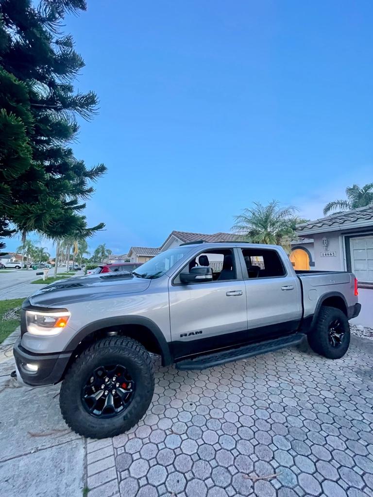

Good morning gentleman,
I put the TRX wheels in the Rebel with 2” spacers I already had, and it rubs a lot on both sides of the Inner fender/ fender liner. I’ll try to put some heat in the liners but I don’t think it will clear the edge. Any ideas?
PS: It rubs when wheel fully turned.

robe2388
Oct 4, 2018
86
86
Reading that rubbing is occurring with 1.25 to 2.0 spacers. By my calcs the minimum spacer needed to fully clear the control arm is 0.737, so 3/4. Do you guys think a smaller spacer would minimize or eliminate the well rub?
I literally cut the inner liners until the wheel wouldn’t touch them anymore and I’m good to go.

Where was the rubbing: Forward inside edge or outside edge or both? Or backside on which side?
Outside edge when wheels fully turned, it was touching the little fender flare plastic edges and some of the liner. Took it off and cut some of the liner with a box cutter and honestly you can’t tell.
