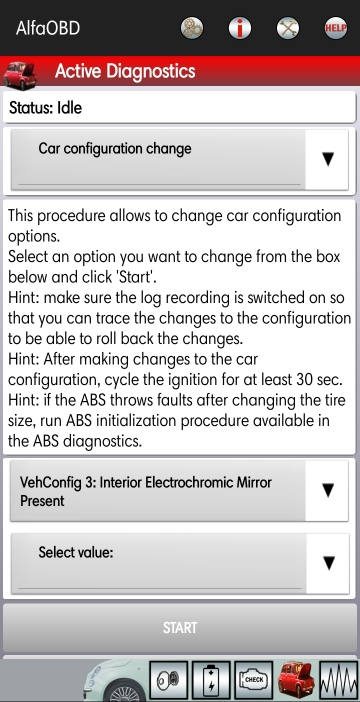

Waiting for my tablet to come in didn’t have anything where I could get Alfa so it says it will be here Monday and once I get it I’ll send info over to Jimmy and see if he can see what’s going on. Still getting the error code after trying lots of things in JScan and setting everything back but nothing is working. I’ll give an update on here after I get my tablet and Alfa tomorrow (if no shipping errors).
Did you check this setting? I changed this too.
Interior Electrochromic Mirror Present: No
In JScan all I have is Passenger and Driver not interior. And my tablet is now coming Thursday of course just to update everyone that is curious.

Alright to all of those who have installed the digital rear view mirror and lost auto dim for 2021+ vehicles only these are the configurations you need to use to get Auto Dimming back and the soft key to work again. Thanks to the help of @Jimmy07 we were able to find the following to get it back.
So, again for 2021+ owners who swapped in the digital rear view mirror, you need to change the following configurations in AlfaOBD and the auto dim feature will work.
LIN & Misc: CRVMM Present to NO
CBC Config I/O Usage: RVDM Present to YES
Thank you. I added this to the first post.
