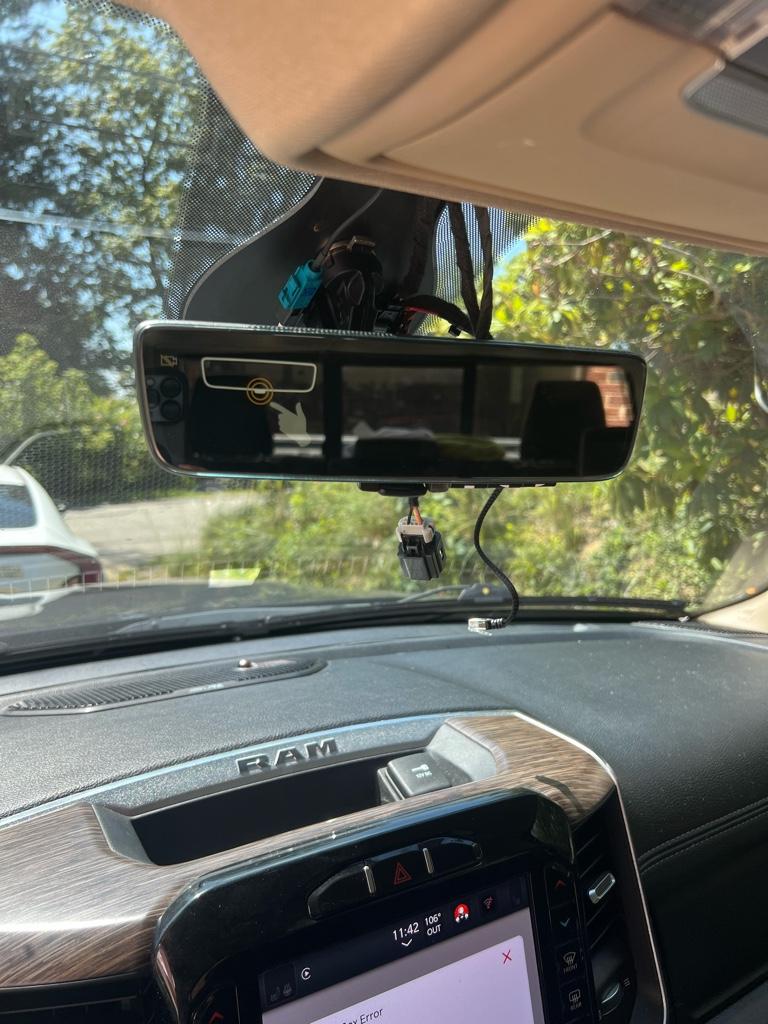

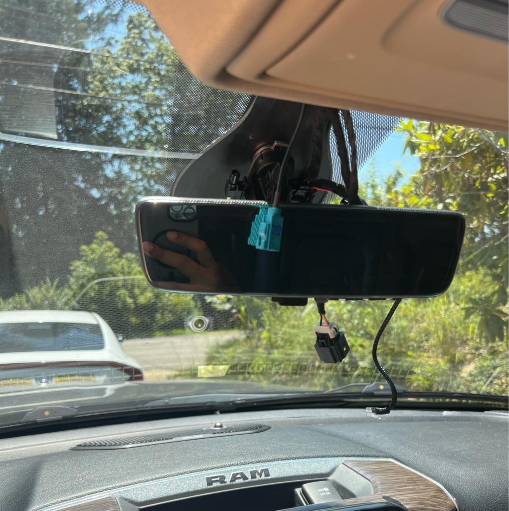

Hello, i did the chmsl and mirror upgrade but im having issues with mirror.
I did make the 2 changes in alfa. I have a 19 truck with 2023 BCM
Here is a list of parts i have:
68448640aa chmsl camera
68448641ab mirror
Im having no display show up on the mirror regardless of where the tab is flipped….
Even if have camera cable unplugged i don’t get any error messages and the mirror just stays blank. Not sure what im missing.
Just to eliminate the cable issue i took a 1ft female to female fakra cable i had laying around and removed the camera from chmsl housing and plugged it into mirror but still same. TIA
[mention]Jimmy07 [/mention] [mention]vincentw56 [/mention]
Any ideas on what could be wrong?
UPDATE: My old mirror has the auto high beam camera so i went into auto high beam and module location settings im Alpha and set them to NO as well but that still didn’t fix the issue….

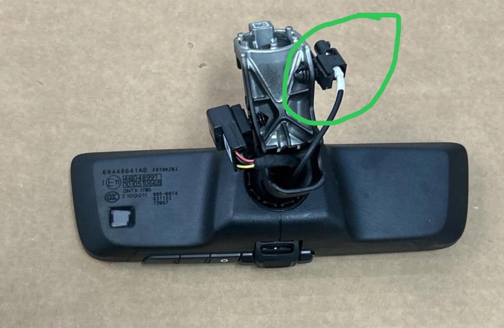

I don't know how it is on the 2019 but when I did it for my 2022, I plugged my falkra cables (the blue head cable) directly into the digital rear view mirror not that weird outlet you have it at
This is the connector i am using coming directly from the mirror. Did you have something different?
What are the 2 other plugs dangling down by the mirror? I have the same setup on my 2019 with a 2023 BCM. No issues, what so ever.
That is for the ACC DASM upgrade and the other wire is for my radar detector. The DASM wiring isn’t connected to anything yet. I just ran it to headliner and the radar detector wire just taps into mirror connector for power.
I stand corrected... literally did this 6 months ago and forgot already. But did your truck originally come equipped with FCW/ACC? Probably have the wrong part, also double check your connection to the brake light mine got loose putting it back in.
I stand corrected literally did this 6 months ago... and forgot.. im getting old. But you got the DRVM directly from MOPAR right?
It came from a used vehicle but the seller is reputable and i bought stuff from them before. Im starting to think its either the camera or mirror module but i think mirror is fine because it at least displays something and i don’t have any way to test camera or know if its working unless i get a replacement. I guess i will have to try replacement camera since its cheaper..
Truck doesn’t have ACC yet but im working on it and thats why decided to do this upgrade while i was at it. I don’t think ACC matters for the mirror since it runs on LIN bus and people got this mirror on other posts and were able to add it without ACC but had issues with plastic housing not fitting
I think the mirror is fine, it shows the symbol to switch to regular but it also shows camera not connected. You have the right digital camera. It is either the camera or the Farka cable.
Yeah im suspecting camera as well. The part number is right (i checked camera housing 68448640aa) and i did eliminate the fakra cable by removing the camera from CMHSL and plugging it into mirror with a different 1ft fakra cable just to make sure its not a signal loss by long cable but still had same issue. Theres no lights or anything on the camera module to tell if its working or not so i will just get another one and update if it fixes it hopefully…
