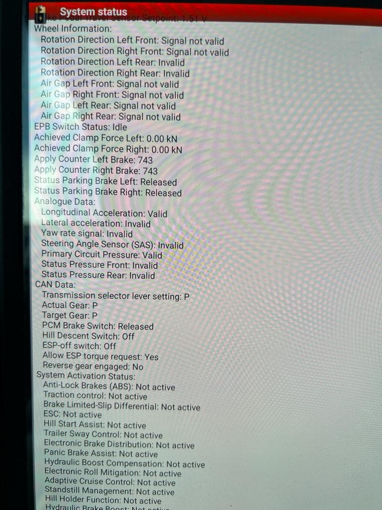

The one thing i saw was the longitudinal and lateral sensor failing as soon as it started. I have seen some people say it works still and some mentioned connecting it to from 2013+ in abs module instead of 2019+ i have tried both with same failure….
I do see this when i read system status
Is it important to have both longitudinal and lateral acceleration as valid? I just have one so far as seen in picture but there is no light or code for anything. For anyone that has done this is it same? I currently use android Alfa version. Do i need to get windows version of Alfa to get it to pass under the 2013+ menu?

I had the same thing happen but if you do system status read it will show you it’s valid for one of them. So far i have had no issues. You can look at my post above. Some people say it works even when it says failed and it seems to be true.
