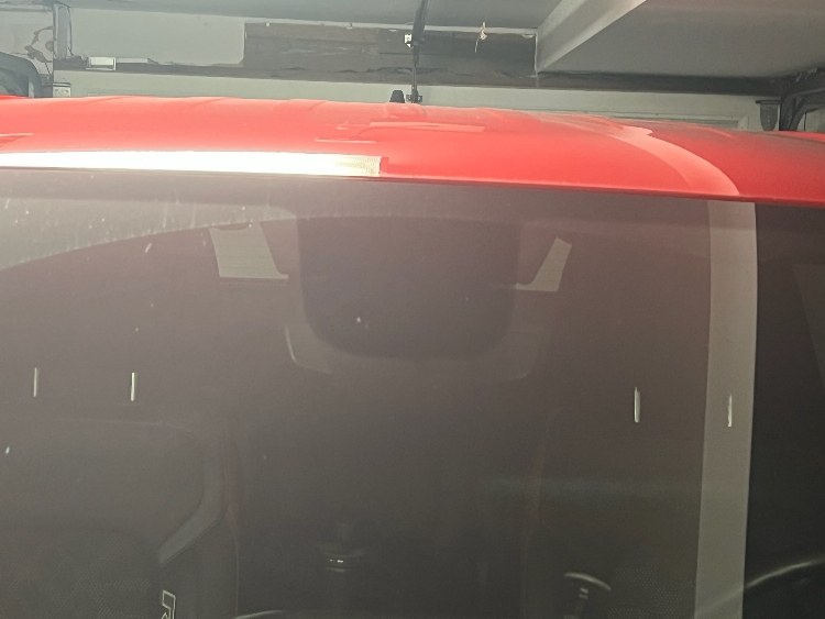

You will need everything. I'm not sure on the windshield, but I think you might need it. I think the camera for auto high beams is mounted to the rear view mirror. The DASM mounts to the windshield.
Ha. Well that’s ok as I have a chip that was repaired, has yet to spread but still bugs me some!

If your windshield looks like this. U will need new one.
