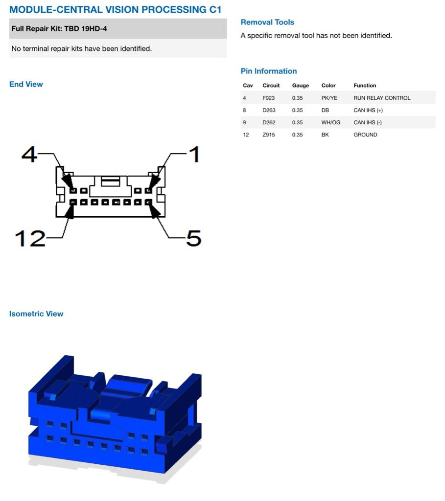

I am trying to cross and diagnose issues as I go. However, here's what I have so far from the pictures. I measured the CVPM power at 2.3-2.6 V DC (at the Can IHS+ to ground). I thought it was suppose to be 12V, please correct me if I am wrong. If that's the case, it would be a harness issue. @Abhi.K

Can bus lines are usually 2-3.5v so thats not the issue. Check your power and ground wires and make sure you have 12v there
Also i see you only have one fuse in fuse tap? You need to have 2. The outer one is what powers the cvpm. Pin 4 and pin 12 is what you need multimeter on and measure for 12v
