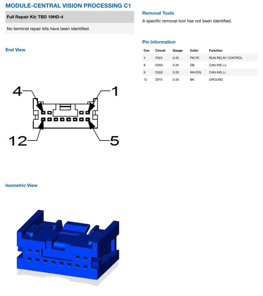

Yes, it is. I numbered them in the picture to match . The CVPM I got is 56029964AF for 22 ram BH. I did buy it from a seller on ebay (as new), maybe I should just go with Mopar store better.

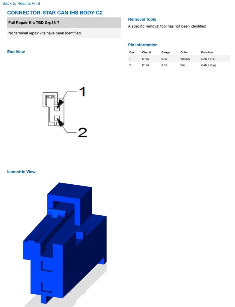

Can you check if pin 8 and 9 are switched?
Cvpm 8 —> 1 CAN IHS
Cvpm 9 —> 2 CAN IHS
Just to test disconnect all the fakra connections too and see if it still acts up. If it doesn’t then maybe its a bad cable causing cvpm to act up.
If all this checks out then its the cvpm itself
If you're in need of a new cvpm, I've got one that I'll make you a deal on! I bought it brand new from the mopar store and then ended up buying a used one so I didn't have to calibrate the new one!
Cvpm 8 —> 1 CAN IHS
Cvpm 9 —> 2 CAN IHS
You were right!! The pins are mixed up. I did a continuity test and It was 8 to 2 and 9 to 1, you can see it in the video ( IMG_7108.MOV ). I didn't notice this until after the test but in the attached picture you can see the pink wire going from Can IHS 1 to CVPM pin 9 and Can IHS 2 to CVPM pin 8.
