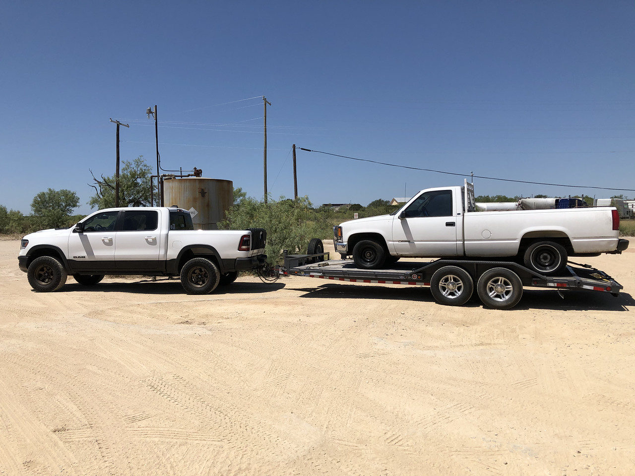

A couple months ago I helped a buddy move his grandfather's Chevy to Austin. My 10k trailer weighs about 2500-3000 lbs. and my guess is the work truck is in the 5500 lb. range. I'm coming from a 2001 Cummins that was tuned and running the same diameter tires as my Rebel. Obviously, I didn't spend as much time in high gear as my (built) 47RE 4 speed behind the Cummins, but I was quite frankly surprised how well it did....especially from a stop. That stump puller 1st gear in the 8 speed is a game changer. And towing at highway speeds through the Texas hill country still netted me 10.8 mpg. All things considered, I'm impressed and can't wait to tow my Jeep all over the country soon!
