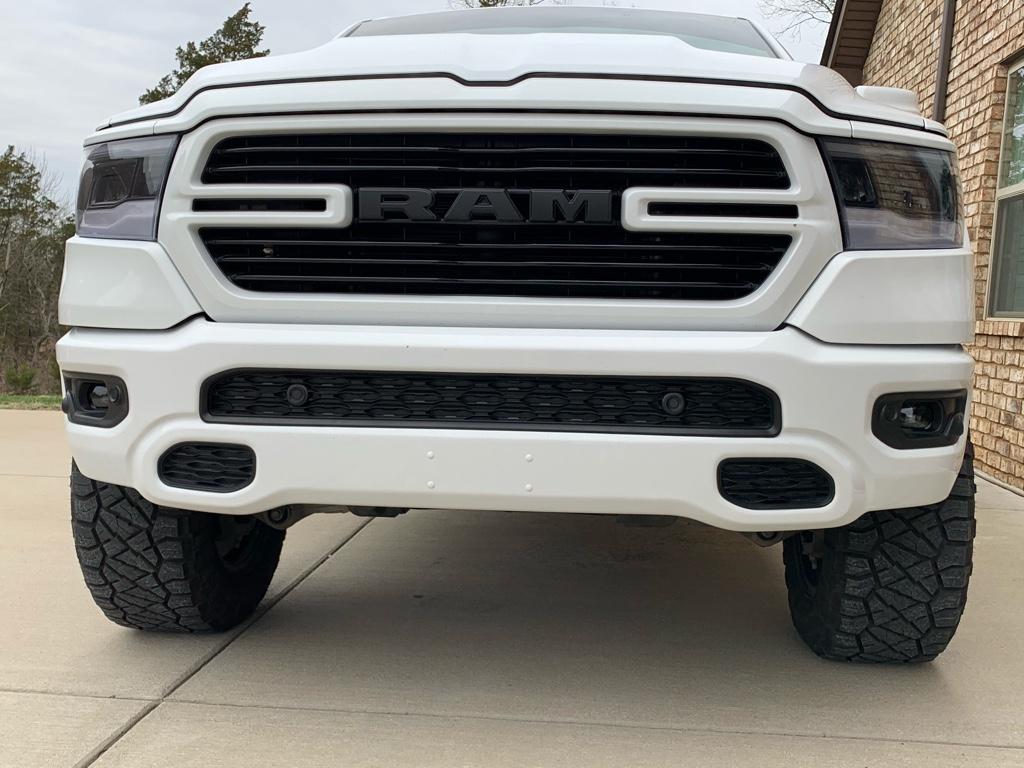

Removed my 5121A13F-3C34-4954-ACA1-568AA01230D7.jpegair dams. A little extra approach angle and a more off-road look. I did more or less identical 74 mile round trips to Home Depot before and after and got 20.3 mpg before and 20.5 mpg after. I doubt that it improved my efficiency, but it seems like it didn’t significantly hurt it.

3.21. I was lightfooting it for sure just trying to get the best mpg I can, but it’s only got 300 miles on it so it isn’t broken in yet either
