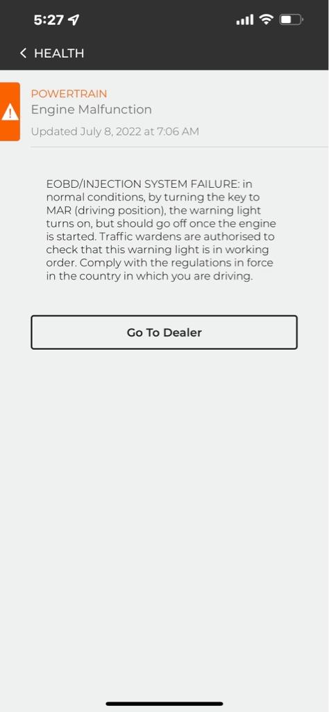

When I took mine off there was still a stores code in the ECU for it, but no check engine light. Is it just the app saying there’s a code or do you actually have a CEL too?
No just in app
No just in app

Since I’m getting a malfunction alert in app
Sure, it’s a comms error, but it’s really not affecting the vehicle in any way
No it’s not at all
