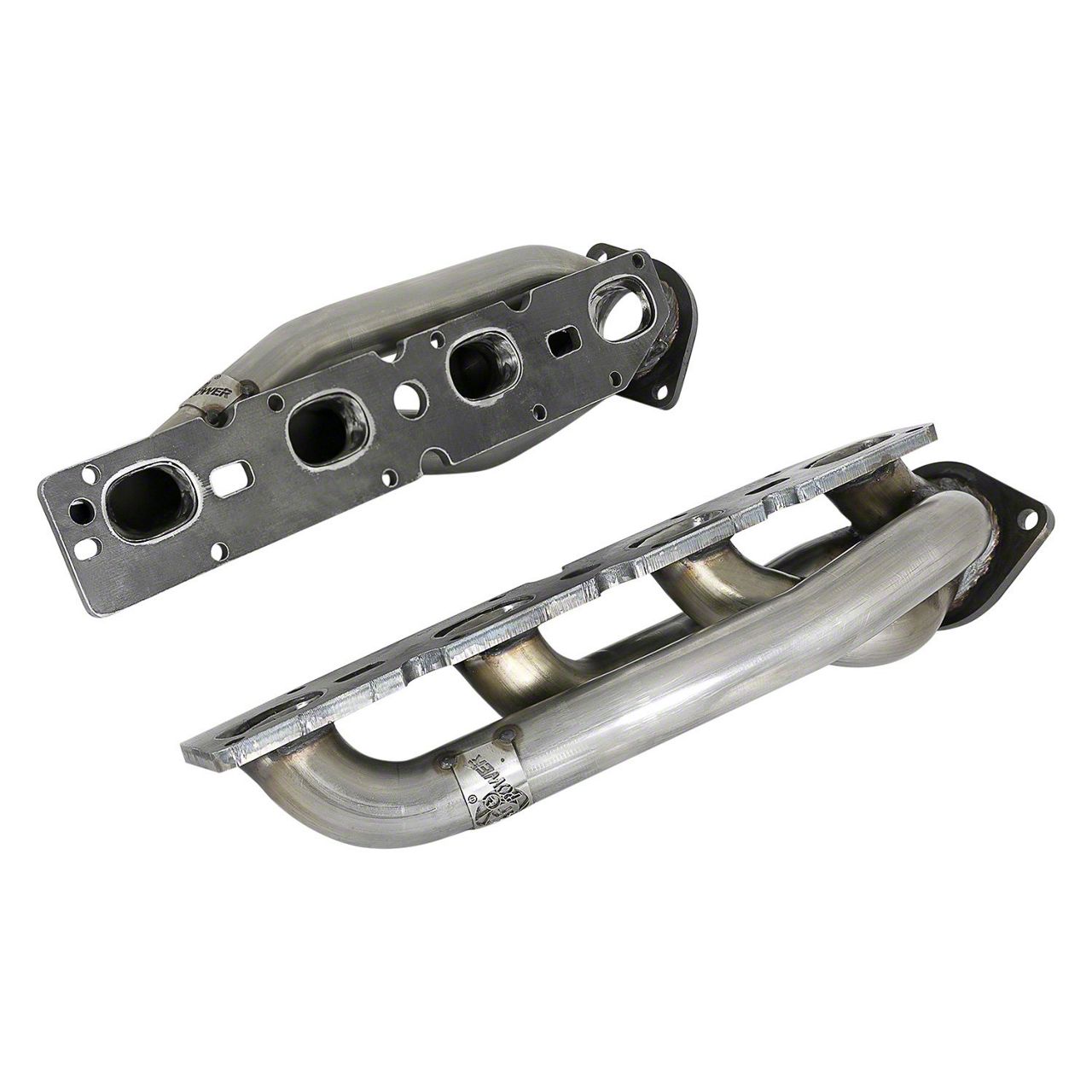

Well my AFE Twisted Steel Shorty Headers arrived today and I took them in for ceramic coating. Unfortunately it will take 2weeks for processing but after that I am going to dive in and tackle this leaky manifold that the dealer refuses to fix. I also bought some ARP stainless bolts to keep these exhaust headers snug to the heads. I do not want to deal with leaky, stinky, noisy manifolds again. Not an out of pocket cost I wanted to spend but the hassle and frustration with multiple trips to the dealer has a cost as well.

I was shopping these AFE and JBA headers online across multiple sites and I found that AFE had random price drops or sales that made them cheaper than some of their vendors.
Also, ARP fasteners for this application: part number 440-1201. Summit Racing had about as good a price as anyone. I chose 12pt heads for helping get a socket wrench on these in tight quarters, and I opted for stainless for longevity, not just aesthetics. I'm going with satin black ceramic coating as this was supposed to be the best at thermal resistance/under hood temp mitigation.

Ceramic coating shop got the headers coated a week ahead of schedule! Happy camper.
There is still some weld splatter that I could have cleaned up, but I don't really care. These are going on a truck, not a show car. The owner of the shop commented on the quality of the AFE headers based upon weight. This shop processes LOTS of parts and she said she has seen people spend thousands on worse headers than this. I am not claiming AFE's are the best, but they are good in the eyes of this coating shop.

I will be taking temperature readings of the factory cast iron manifolds vs these ceramic coated headers for posterity’s sake.
