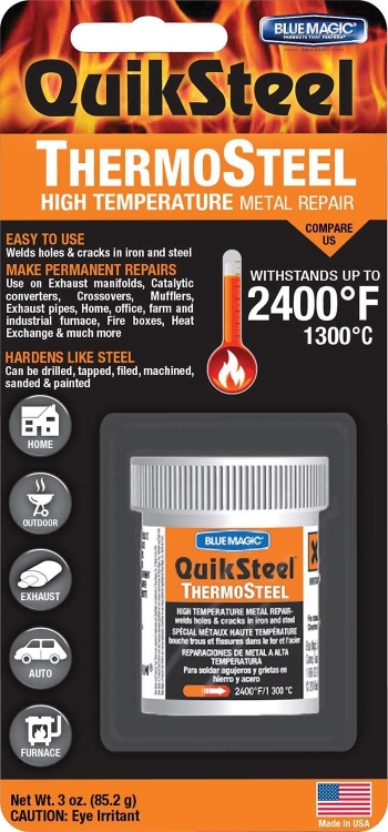

early model Wranglers with the 3.8 had the same issues with the factory manifolds. I "patched" mine with Quick Steel ThermoSteel high temp metal repair. Worked amazing and held up for 50,000 miles then I sold the Jeep.
Good to know, thanks for sharing.
