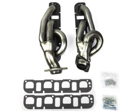

Without your location in your avatar, I don't know if these would be acceptable to you. They would work fine for me. I had to do this on my last truck.
There'll be more info here. https://5thgenrams.com/community/threads/shorty-headers-for-21-ram-1500-5-7.27811/
CARB acceptance for this type of product is a legal, not an engineering, purchased rating. The actual tailpipe emissions will not change, even if you did a complete hand fabricated exhaust and used universal cats of the same type and location. Same with a CAI; just a purchased rating, doesn't change the actual emissions. For these types of replacement products, CARB is an extortion racket. I understand if you must comply in your jurisdiction though.
I'm not worried about the slight amount that would get out of that crack, since I mow my lawn...(y)
Thank you for the links, much appreciated! Now let's exercise the ole credit card. I am in a CARB compliance area, and I get that that an EO for headers is just administrative, not enineering/real world. I'm not too worried about this leak, I was feeling frustrated with a fairly new truck (this is not the only issue it has) and yelling into the wind.
Fixing these manifolds is not sexy work, but a set of shortys sure is :). I'll move over to the header post. Thanks again Bt10!
