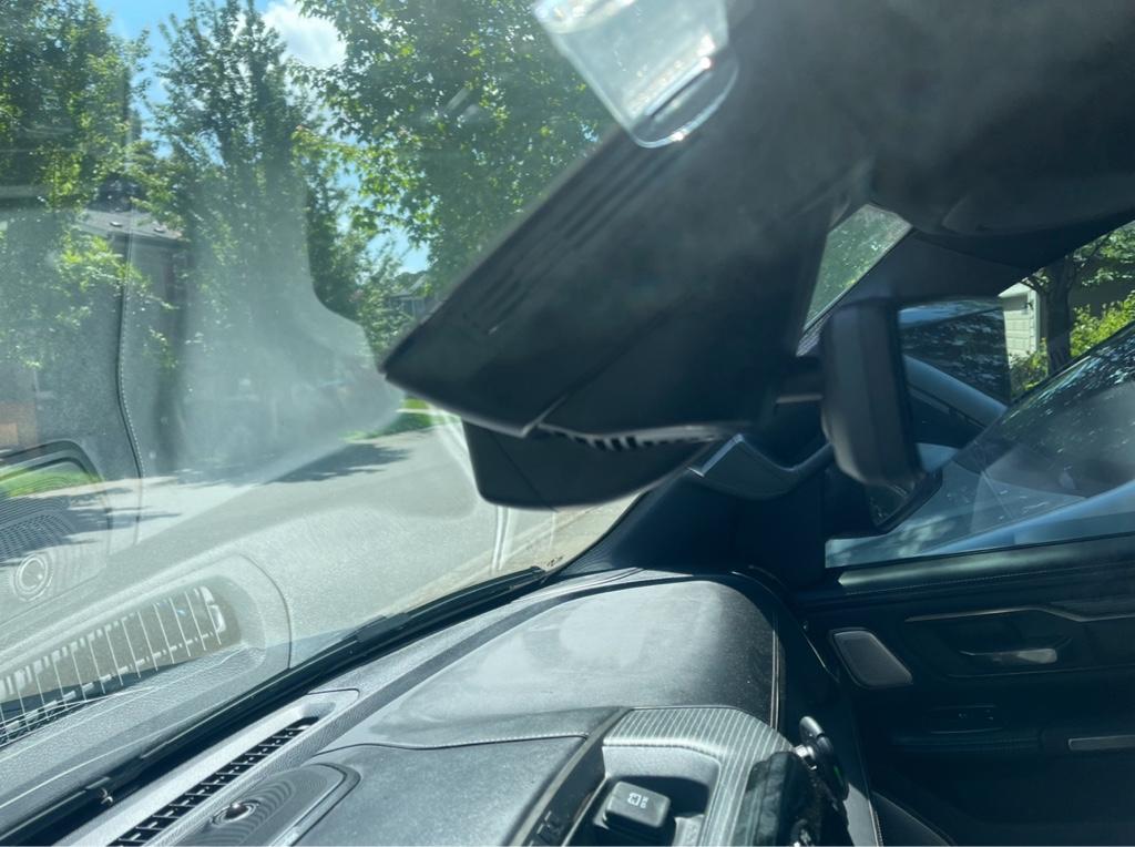

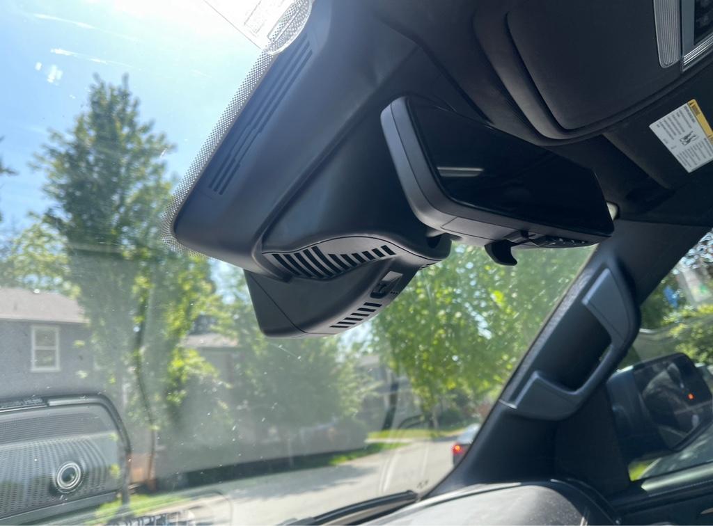

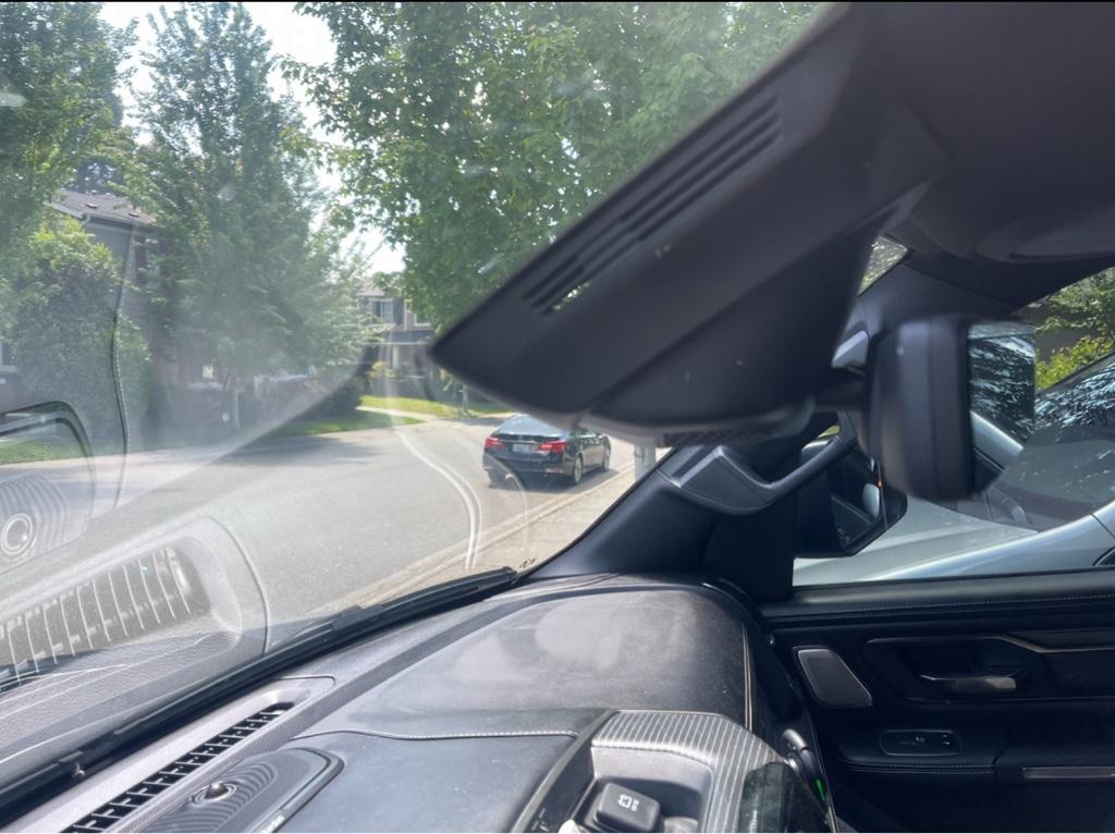

Here is stock without the fitcamx
And with…
And with…
The mount won't work with that. The comma works as a dashcam so I don't see a reason for another one. I think you will find issues with the two working together unless you move the FitcamX someplace else.
