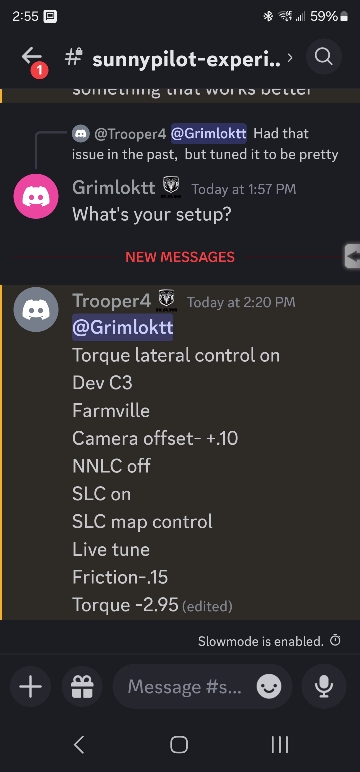

Great information, thank you for the reply!These are the settings Trooper suggested and work best for me.![]()

Yeah it's actually too bad that we can't get a good definition of what adjustment does what at least in layman's terms for those two settings. You cannot Make manual adjustments under the NLCC.Mine does that, it's gets even worse sometimes we call it the "death wobble"
I find that if you increase the friction number it seems to do it less if I recall correctly. I'm not sure if you can even adjust the friction with nlcc turned on?
I also have an 22 Limited with OEM 22s and air suspension which always struggles with comma for some reason. I believe I have been running .2 friciton and 2.5 last accel (I would need to double check the last accel). With newer builds I have pushed friciton to .3 which seems to be working better, but it's so hard to understand which settings improve because you need to fiddle with it while going 65 mpg on the highway and not get into an accident.
It's been explained several times in discord. I'll see if I can find it and add it to the FAQ out there.Yeah it's actually too bad that we can't get a good definition of what adjustment does what at least in layman's terms for those two settings. You cannot Make manual adjustments under the NLCC.

Friction is the force it takes to overcome turning the steering wheel. If your wheel is really easy to turn, you need less friction. If it is really hard to turn, you need more friction. It is all the friction created by everything starting at the steering wheel all the way down to the tire and pavement.I'd love to read it. Let us know where. I've use the search function within discord in both the RAM and general comma AI forum for both those terms and did not find anything.
Sent from my SM-S918U1 using Tapatalk
That's the problem I have now. My settings that were good aren't quite right anymore.Keep in mind, what works on one release, may not work on the next one because of the change in the model. The model is what determines steering. As new models are released, there may be changes needed to these values to compensate.
