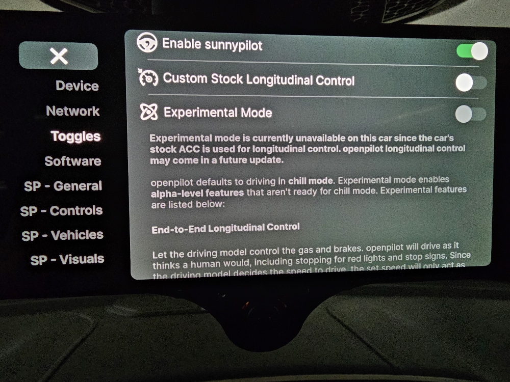

Should I choose a different vehicle in Sunnypilot and use the non-adaptive cruise control in order to use these experimental features?

You can't use experimental features on the Ram yet. I'm still working on the longitudinal controls.

Thank you. I didn't know if it was as a result of the truck having the adaptive cruise control built into it. I know with my model, I also have the option to use a non-adaptive cruise control. So, I thought that might work. I guess I'll just hang tight.

The comma doesn't have the ability right now to control the gas and brake. Not from stock anyway. We have it sort of working but there's some tweaks that still need to be done. And I need to upgrade it to the latest release of commas software.

Not sure. I got word that comma themselves maybe working on it.
