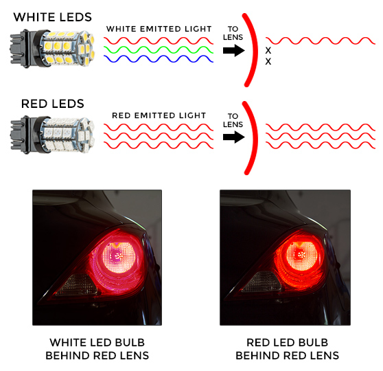

For those of you that are going to replace your third brake light and cargo bulbs, buy ALL WHITE BULBS. You should not install a RED bulb in a red lens housing.
Very interesting video and counter to everything I have ever heard or been trained on.
I used the red one from Diode Dynamics because that's what they recommended for this truck. I played around with it and while it is a red LED, once installed it appears just as bright and the same color as the "1000 lumen" Amazon cheap white LED. I'm not going to make a science project out of it since it looks virtually identical and should not burn out in 3-6 months. DD also gives a 3 year warranty so I'm done.
Here's another discussion regarding the color of LED for the application: https://www.superbrightleds.com/carbulb_notes.php#ColorChoice
