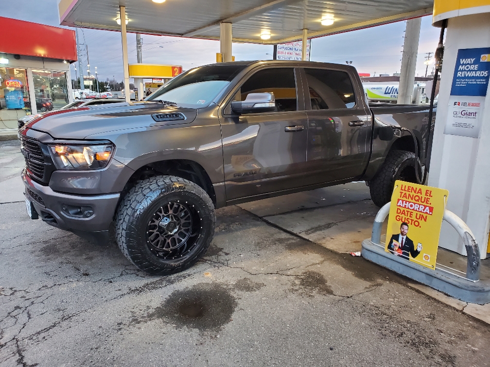

Looks good! Thinking of doing exact same setup. Ride still ok after having driven a few weeks now? Any problems when getting alignment done? Thanks
So far ride is good, a little more rougher than stock, gas milage is down to 12mpg

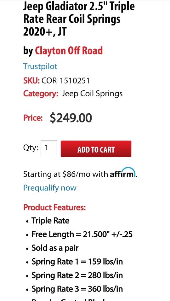

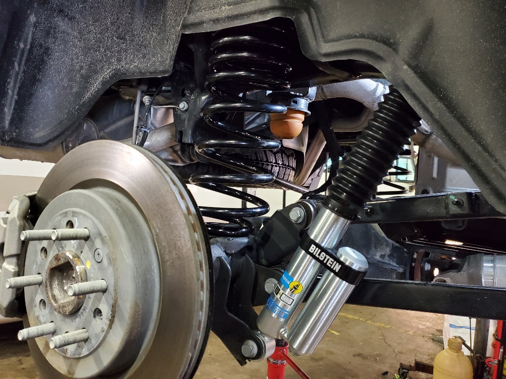

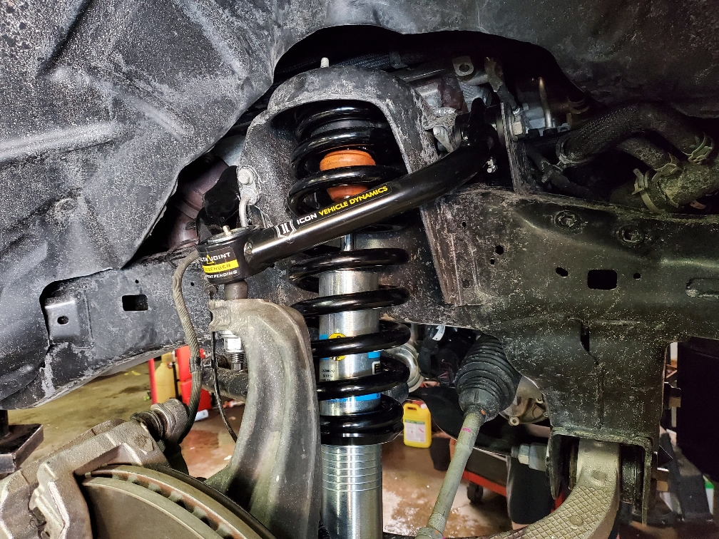

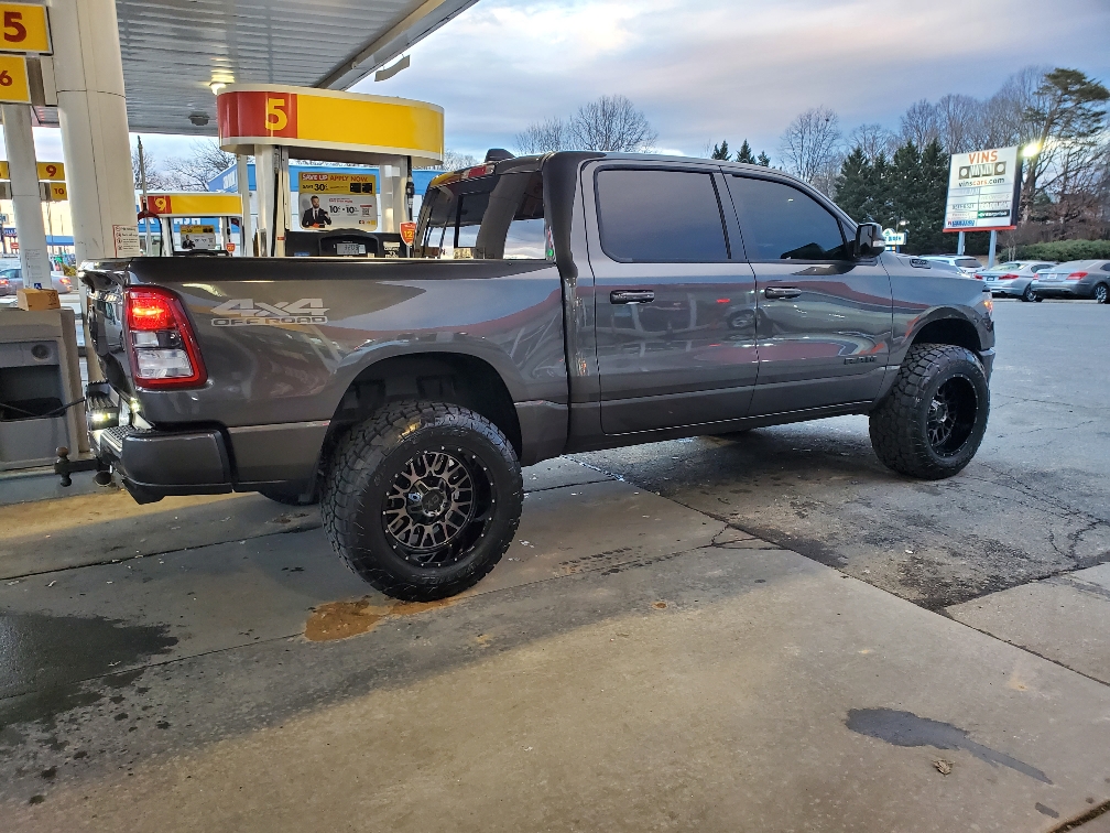

This is 6112s + 1/2" Motofab Spacer and Icon UCAs.
5160s in the back with Clayton Offroad Gladiator springs.
Definitely a tad more stiff compared to stock, but handles better. Eats up washboard type stuff beautifully at speed.
Nice truck! Do you have ORP springs installed or did you use Blilstein springs?
What setting do you have the 6112s on and are the Claytons the 2 1/2” lift ones? Truck looks good.
The 6112s are on the #8 ring. Also added a 1/2" Motofab puck spacer above top hat.
Clayton's are 2.5 lift for gladiator.

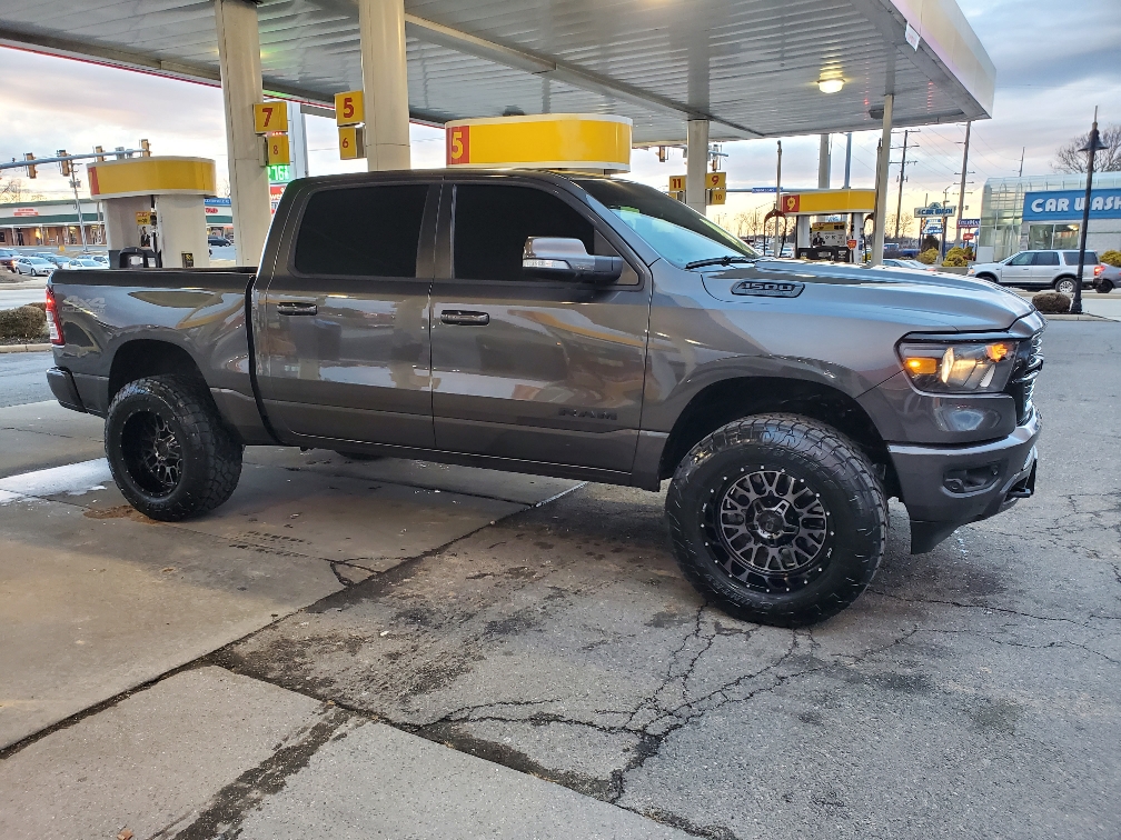

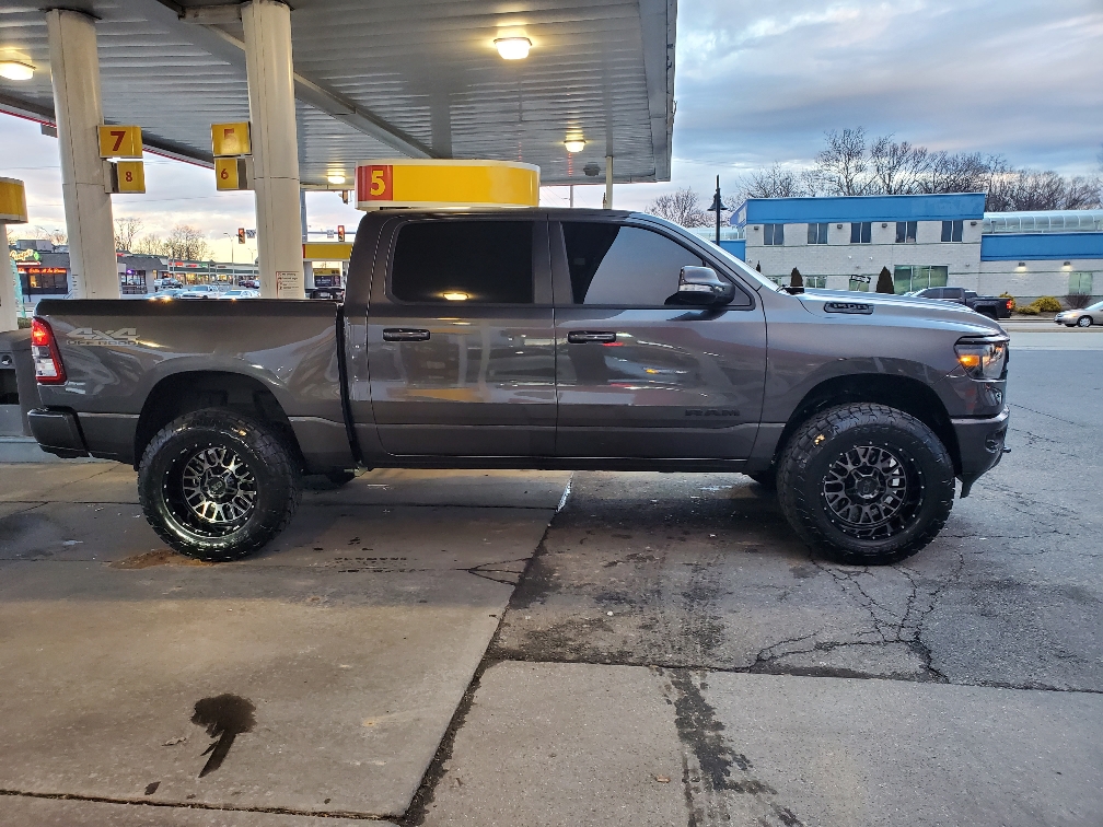

Before:
After: Don't mind the dirt..
Definitely rides stiffer, but not as stiff as my Wife's 2020 F150.
It also got rid of that 70's Caddy floatyness.
Just ran 800 miles this past weekend with a good load, up and down mountains of West Virginia. Truck ran and towed fantastic. Very comfortable, really felt stock. Impressed with the Clayton rear springs and Hellwig sway bar.
