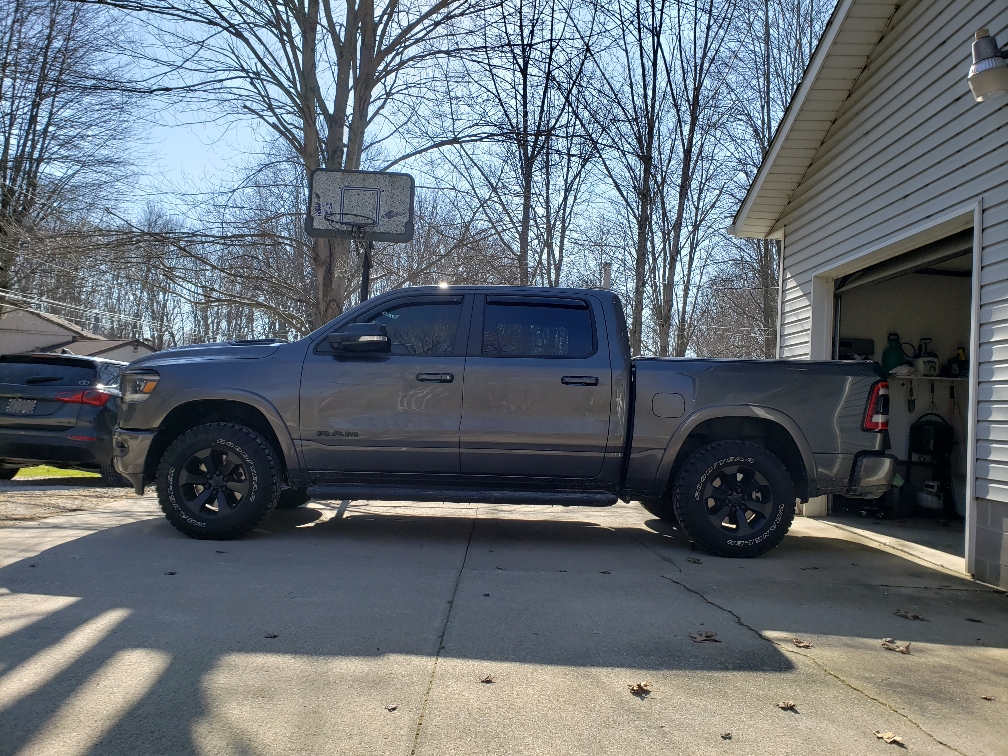

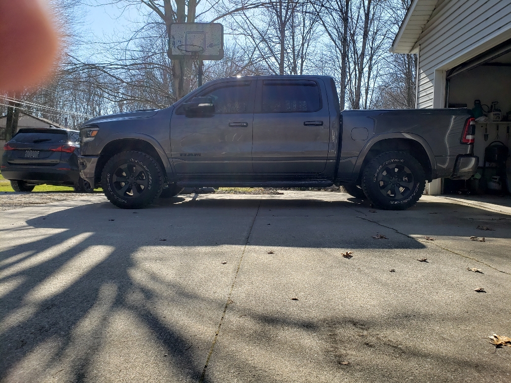

Got mine completed. Setting number 5, matching 5100s in rear, and replaced the wheels with a set of Rebels.
Looks sharp man. I’ve already got my 5100s for the front of my non-ORP bighorn. Contemplating on whether to get the 5100s for the rear as well. It’s probably hard for you to judge but do you think the rear 5100s are worth it? Thanks

I put 5100's on the rear as well. Worth it to me. The valving on the 5100s is different than the stock rear shocks. Not sure how drastic the change would be, but to me I wanted the best ride possible so matching the valving and stiffness made sense. I am installing hellwig when it arrives this week, but I can already tell a massive difference in handling and body roll with the 5100s.

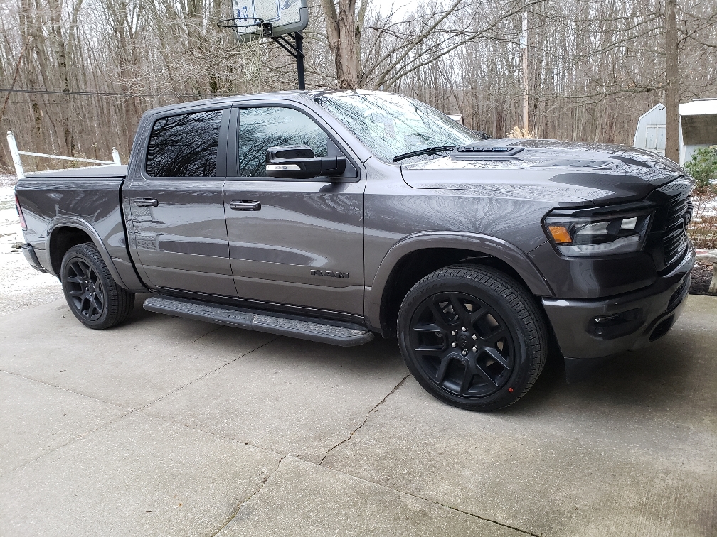

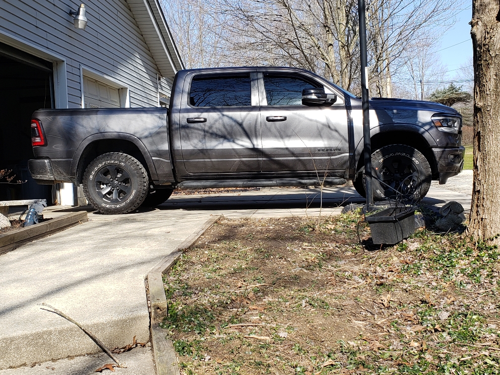

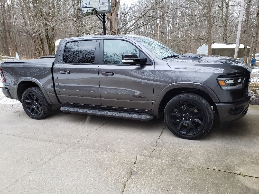

Can you post pics of the before and after? I have a granite crystal and I'm curious to see how it looks.
Here's a few. The first2 pics is from the day I bought it with the factory 22's. And then with the bilstein installed with the rebel wheels.
That looks really good! Are the tires
That looks really good. Are those the 275/70/r18's from the Rebel as well?
