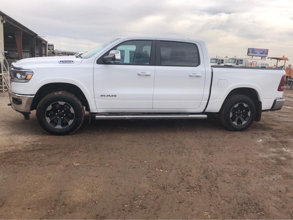

Finally got mine completed, Clip#7 up front, 1.5" ICON springs in rear, 35x11.50x20, stock rims. Total gain(with tires) in front ~4" ( 36.5 to 40.5), Rear total gain about ~3" from 38.25 to 42". So far the ride is about the same, maybe a little more bounce in the rear, road noise is higher then stock, fuel mileage is coming down quickly(expected). Best part I still fit in these small Texas garages

Got mine completed. Setting number 5, matching 5100s in rear, and replaced the wheels with a set of Rebels.
