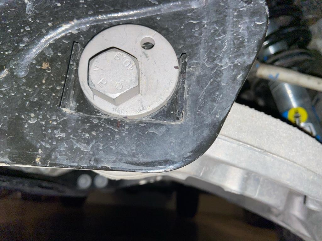

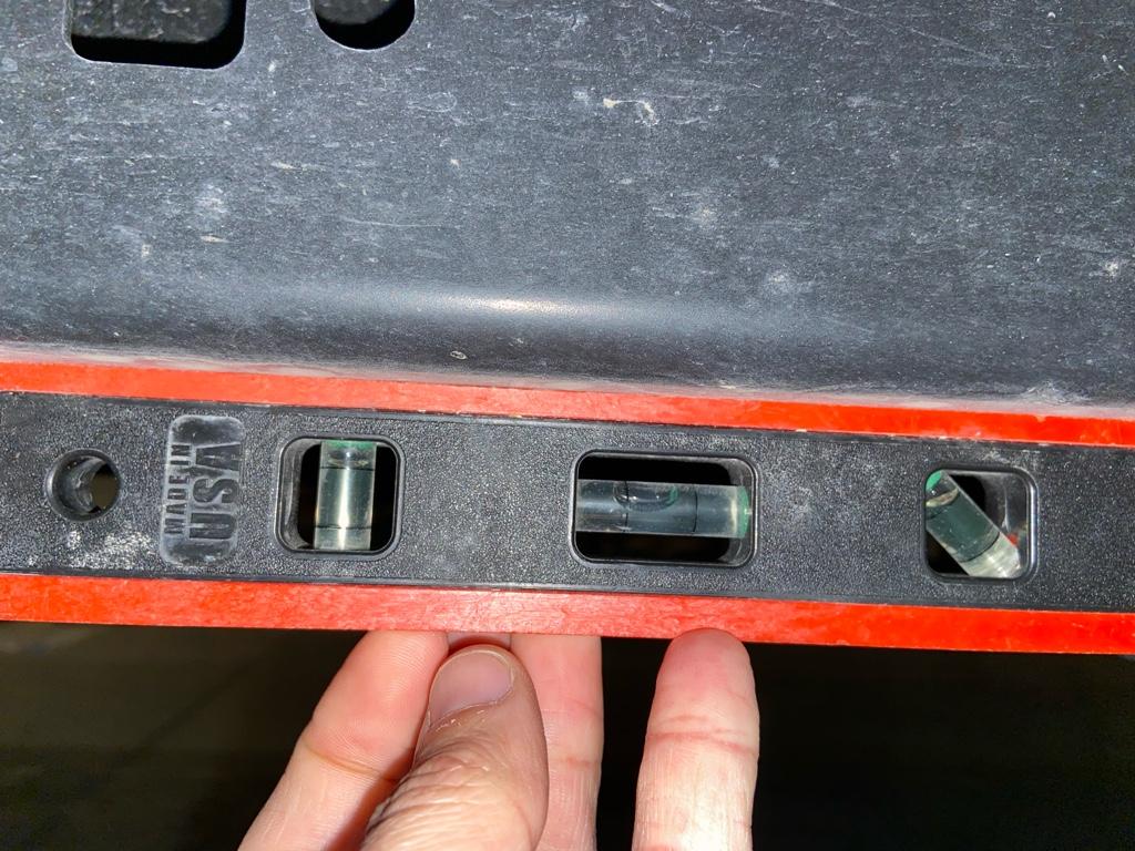

Post up a pic of your rig, would like to see what it looks like at #5Just as a follow-up, I set my new 5100s at #5 position on my ORP crew cab. Now that all is settled, I appear to be dead even front to back of measuring to the wheel wells. That said, when I put a level on my running boards, the truck is clearly sitting nose high. I also put the level on the frame and see the same. I think a #4 clip position would actually “level” the truck.
Also, I’m going to post this info to hopefully save some of you the $100 I spent on alignment after install. I thought it was odd the shop didn’t provide me a pre-measurement on my alignment sheet. I had marked all of my alignment cams prior to installing the 5100s, and you can see clearly they adjusted the cams only very slightly (same on both sides) to put be in the center of the spec range. My guess is the truck would have been fine without this, but you can probably safely cheat yours similarly if you know you’re well aligned prior to install.
Pic below is front of truck looking back, on the driver side. Notice my pre-install marks and the $100 nudge from alignment.
Full disclaimer, I am not an alignment technician nor do my results promise the same for your truck. This was my experience and your results may vary![]()
