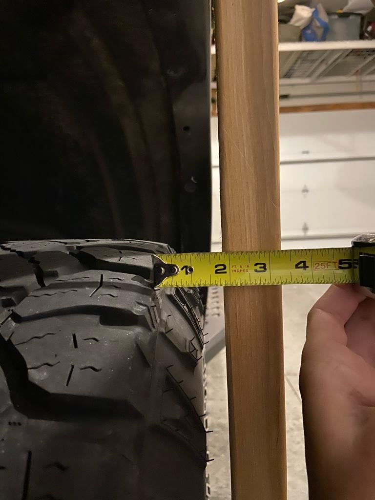

Remeasured and after the lift my front wheels moved inboard 1/4” each. That was enough to change my mind on the spacers. I called BORA and updated to 2” front spacers. The outside lugs on my tire tread sit 1-7/8” inside the fender flares currently.
Have you gotten an alignment yet?
That could be because your camber is off.
Regardless 2 inch spacers will look good just figured I'd mention why they could be inboard a bit.

Yep, did the alignment yesterday.
I’m a bit torn now. A fellow member “Dookie” just mentioned he had a lot of rubbing with 2” wheel spacers.

I returned my 2inch and got 1.5 on the way.
With the lift and if you do the mod to the the inner fender where you bend the tab you should clear.
