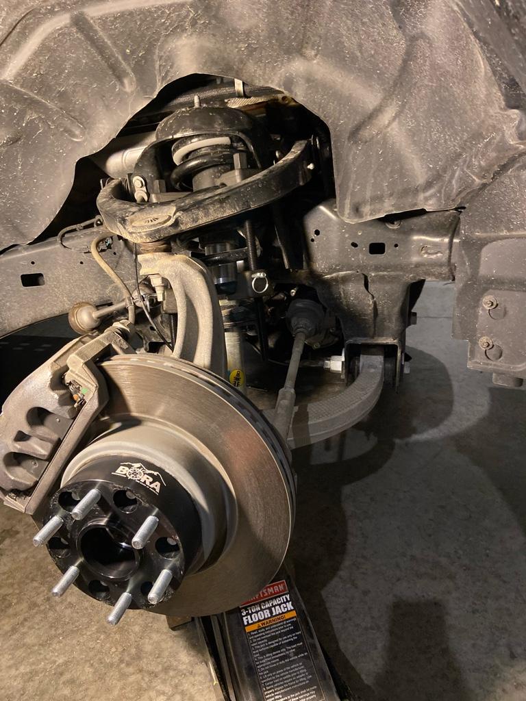

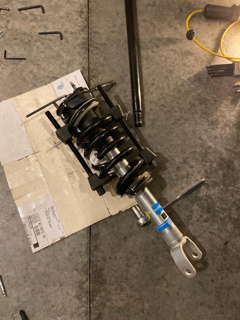

Went thru round #2 tonight, as I’ve found #5 position settled 1/2” high on my ORP Crew Cab with Rambox and tonneau cover. Just dropped it to #4 and I’m back to level after a short drive.
You get better after some experience. This time took 2.5hrs to rebuild to #4. I tried to get fancy with the spring compressors on the truck by raising and lowering only one side after removing the sway bar, but there wasn’t enough travel to take the spring load off of the spring clip.
Had to do it the old fashioned way
