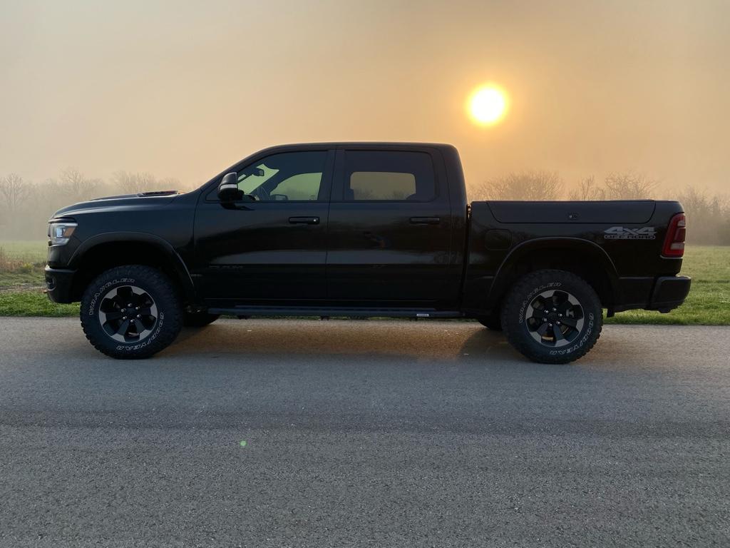

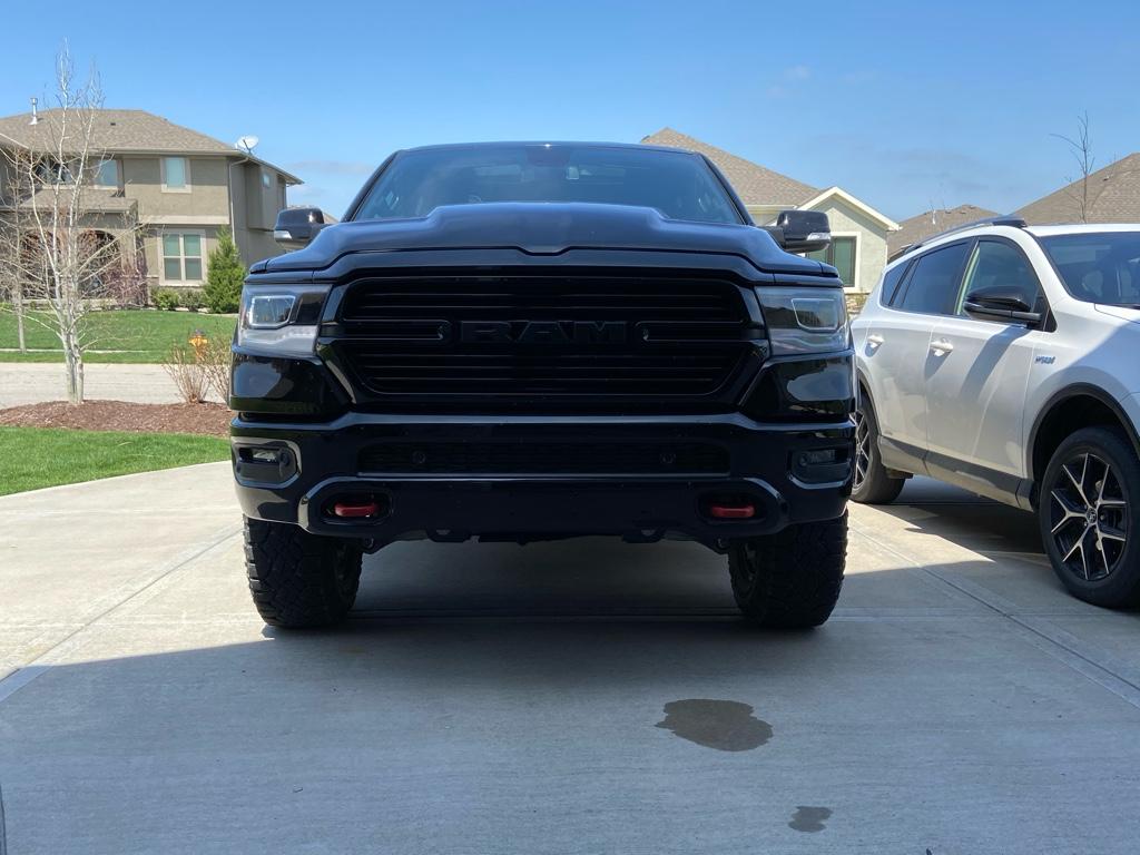

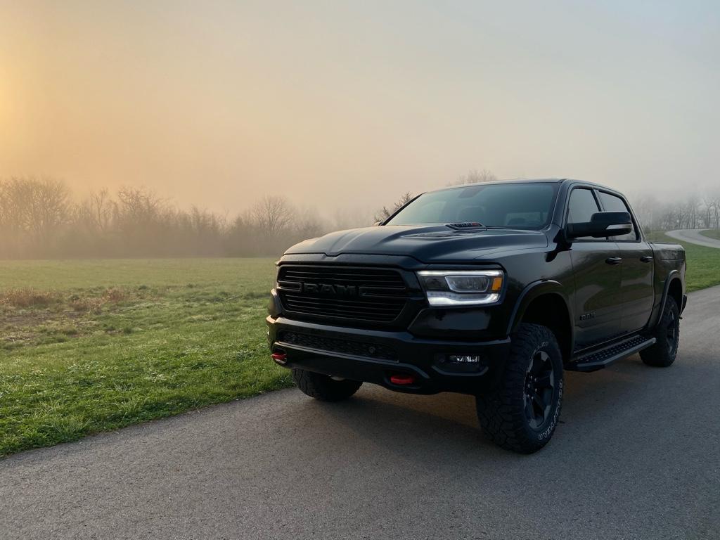

After some more driving, I think it’s finally settled on height. I’m basically level as it sits right now, measuring roughly 40.125-40.25” from ground to fender on all sides. Each time I stop I get a slightly different measurement.
Ride improved a bunch since the first couple of miles, it seems really stiff right away and now I’m enjoying it more. Definitely rides stiffer than stock, which is to be expected, but isn’t rough by any means. The 5100s definitely have a faster, and more controlled rebound response and certainly soak up gravel roads better.

Picked up a set of Rebel takeoffs from a local guy who changed up to new wheels. The more I looked at wheels, the more preference I found in the Rebel wheels for the look I was seeking. Super happy with how it’s turning out... now I just need those wheel spacers to show up so I can get rid of this “truck on stilts” look I got going
Badass. You get 2” ones? And I agree on the stiffness at first. My wife was telling me it’s much stiffer than stock at first but lately it feels much better.

Right after install I had about .5 inch of rake
Just so happens after I put all of the tools away and cleaned up the mailman shows up with my rear spacers lol.
So of course back to the garage to throw them on, but only took about 20 mins start to finish for the rear.
clip no.5 , no rear spacer
After 1.5 motofab rear coil spacers
And a bath of course
Maybe a little too much rake, (driveway angle doesn't help) but we'll see when after a few weeks and after I install the 1.5 wheel spacers how I like the look.
What tow hooks are those?
