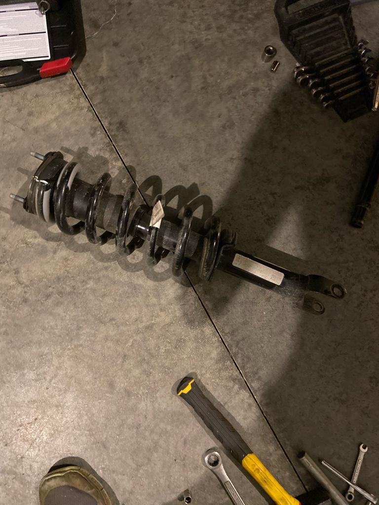

The rear spacers are these right here. And using the spring compressors that I used up front what I did was crank one wheel way up, then install the compressors and unbolted lower shock mount and stabilizer bar link and lowered almost to the ground. Spring came right out and puck plopped right in.

Word to the wise, make sure you have a pass-thru socket set before starting this project. Otherwise, you might end up at midnight like I am with this current situation...
Happened to me too. You need an 18mm pow’s through socket and a 6 point 8mm deep well socket to hold the shaft.
Agreed. I’ve made it my whole life without ever needing a pass through socket set. Until this job came up. I’ll probably never use them again so I bought a set from Harbor Freight. Luckily I read about needing them beforehand
A 1/4” deep socket passes right through a larger regular socket.....i then used vice grips to hold the larger socket and my impact to drive out the nut using the smaller socket

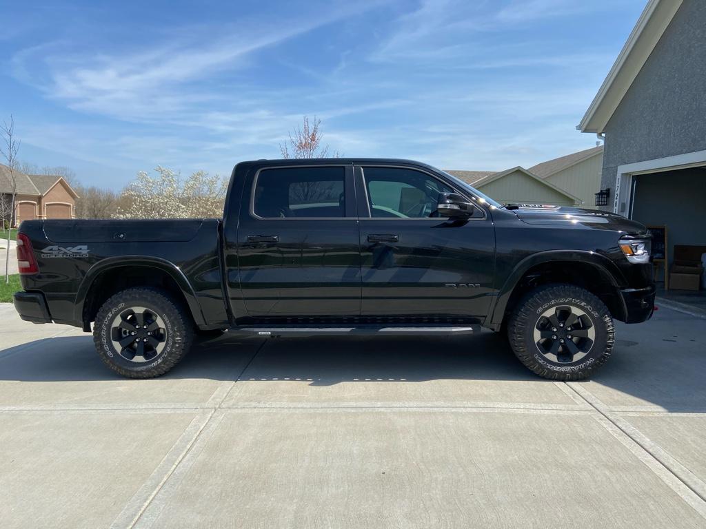

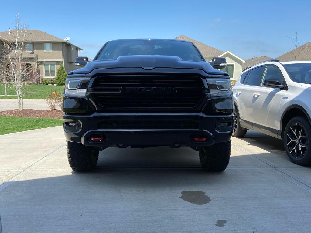

Got them on and went for a really quick drive. They’re noticeably stiffer now, which I think can be expected. I’ll need to play with tire pressures a bit more now as I’m running them pretty high. I’m sure I’ll get used the stiffer ride, but it’s certainly not as plush as before. Not sure if it will soften a bit with time?
Looks good and I’ll appreciate the added clearance for sure. I’m not sure how long it takes to settle into place, but it’s pretty close to level from a quick eyeball. I’ll put a couple more miles on and take some measurements later.

I’m going to be limited in garage door clearance. If I end up finding the front settles higher than the back, I’ll go down to #4. My guess is the biggest I’d ever run is 34” tires in the future.
Curious how many miles before your suspension settled. I just scheduled an alignment for tomorrow afternoon, want to make sure I get it stabilized before going thru that.
When I lowered mine onto the garage floor the first time my front measured 24” from center of hub to bottom of fender flare. I drove it a couple miles and it measured 23.5”. The next day I drove to my farm and back. That is a 70 mile round trip, and it measured 23” . It has stayed at 23”. Not saying it took 70 miles to settle, that’s just how far I drove.
Keep in mind my truck has the factory fender flares and that changes the measurement a little.
