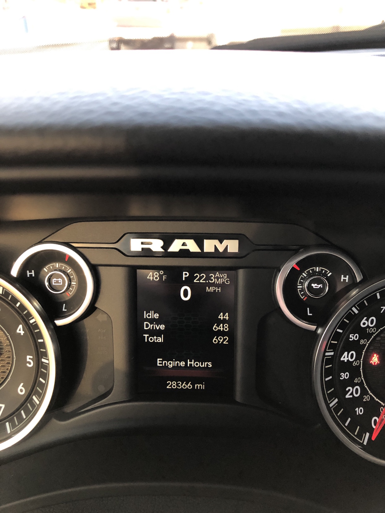

Here’s my input. I took out the carbon filter and put a K&n drop in on then took a round trip to Graysville Tn from Johnson City. Cruise was set at 70 and here is my evic mpg. My actual was .2 mpg less.
I was averaging 19.5-20 before air box mods. That is with a borla muffler swap.

My evic actually was at 24 or 25 till I got off 75 and drove through back country. I was blown away. I did the mods Thursday night. Filled up white Shell mid grade (all I use) before I did the trip and cleared the evic to test. I don’t see how a cai will give more for the $$$ compared to it. I was really surprised, especially since the K&n was for the cost savings of a reusable filter. Didn’t expect much if an gains.
Very impressive. What gears do you have?
