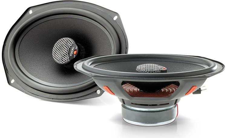

I was looking at reviews of higher quality speakers. Since I'm not very skilled, figured I should stick with a 2 way 6X9 because that's what my system is already tuned for. I saw that I had about a week left on my 60 day return policy with Crutchfield, so replaced my front Infinity Reference with a set of Focal ICU 690.
I really like the sound on these and they have more mid-bass thump to them.
Are those plug and play? I don't really do/know stereo stuff beyond popping out the old one and sticking a new one in its place and don't really want to learn, but the base level speakers in my truck are trash. I'd buy a set if I could just stick them in and plug new wires in.
Yes, it would be plug and play. However, they're 4ohm whereas the OEM speakers are 2ohm. So they will have less volume, but not by much.
