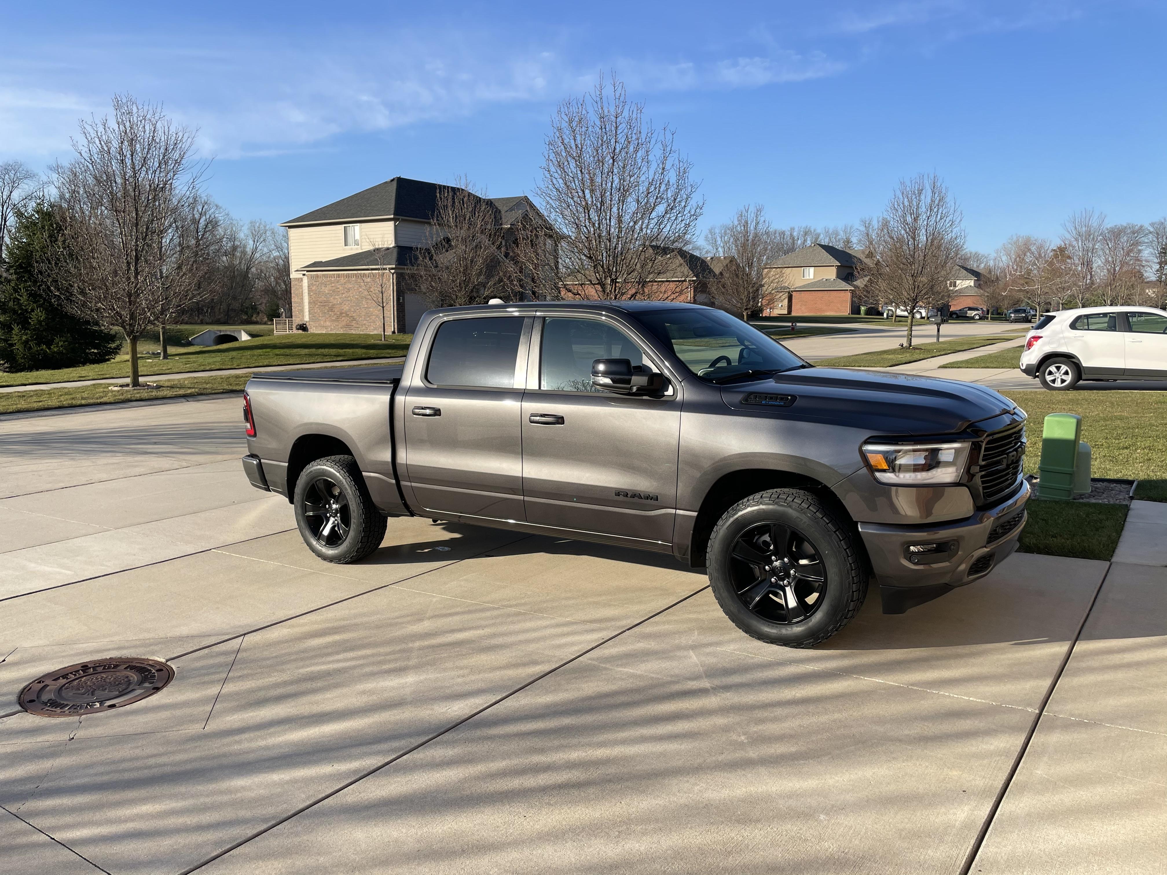

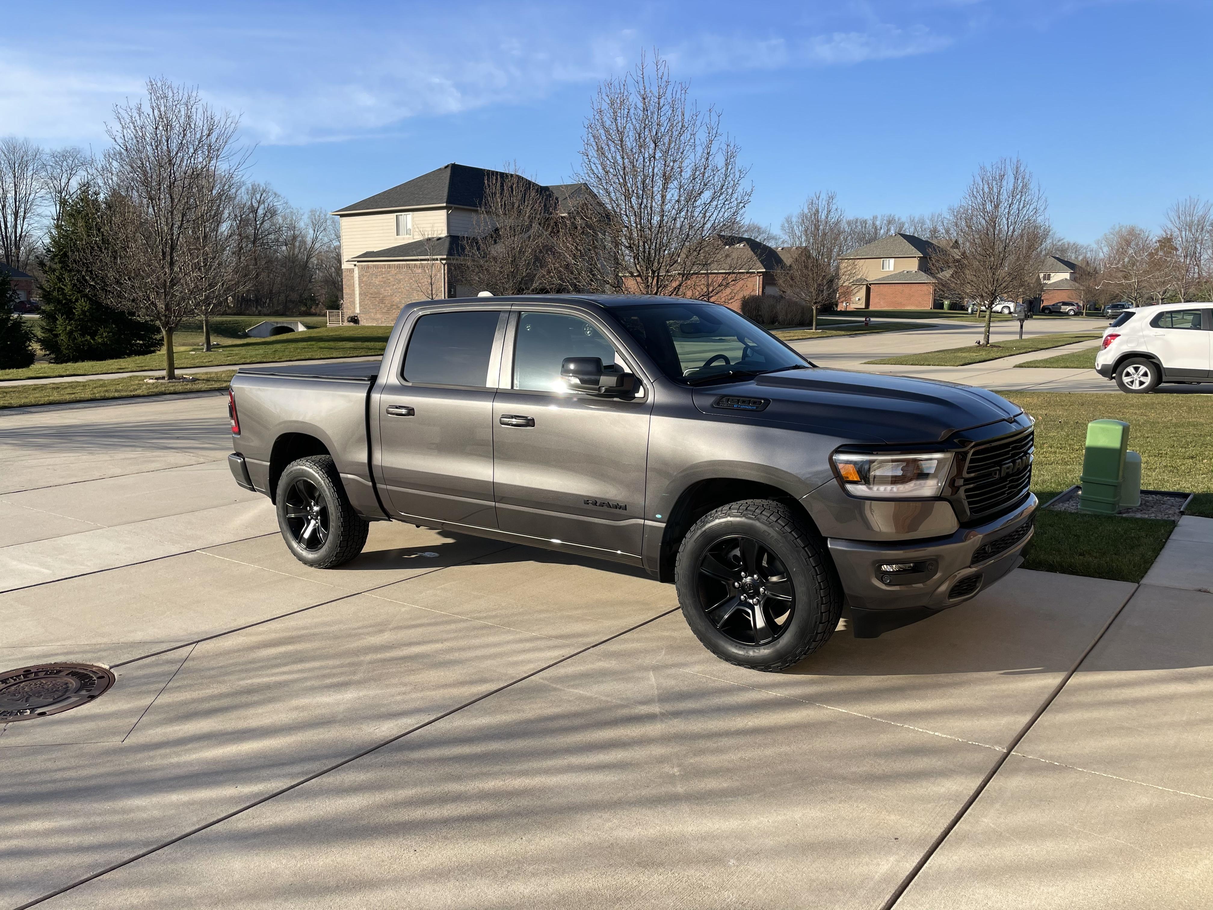

Finally got around to installing my 6112s on the front. I went with clip #4 to preserve some rake and suspension droop.
The front raised just under 1 1/4" at this setting.
This is the factory non-orp Hemi 4x4 Crew Cab suspension.
Before:
After:

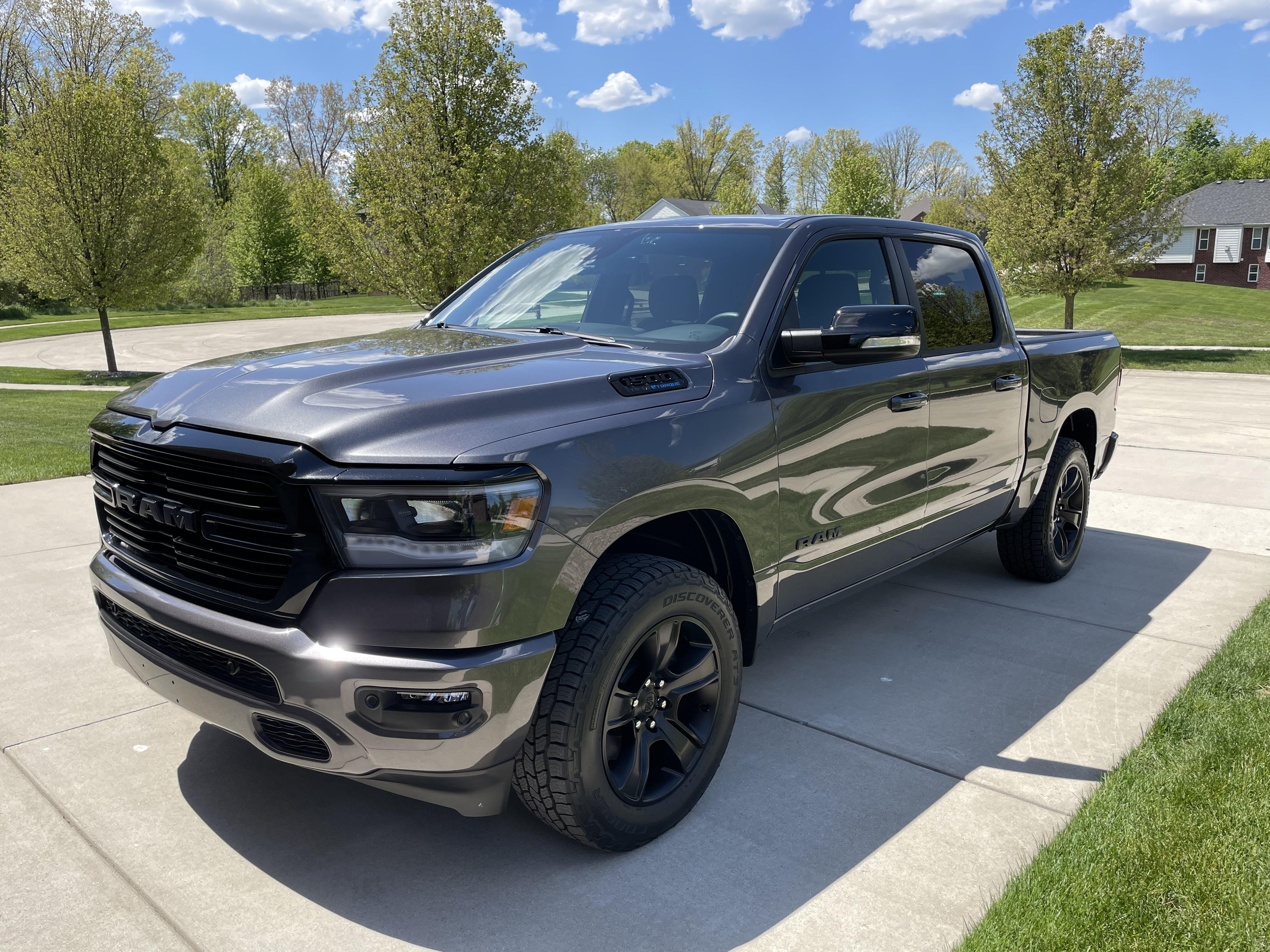

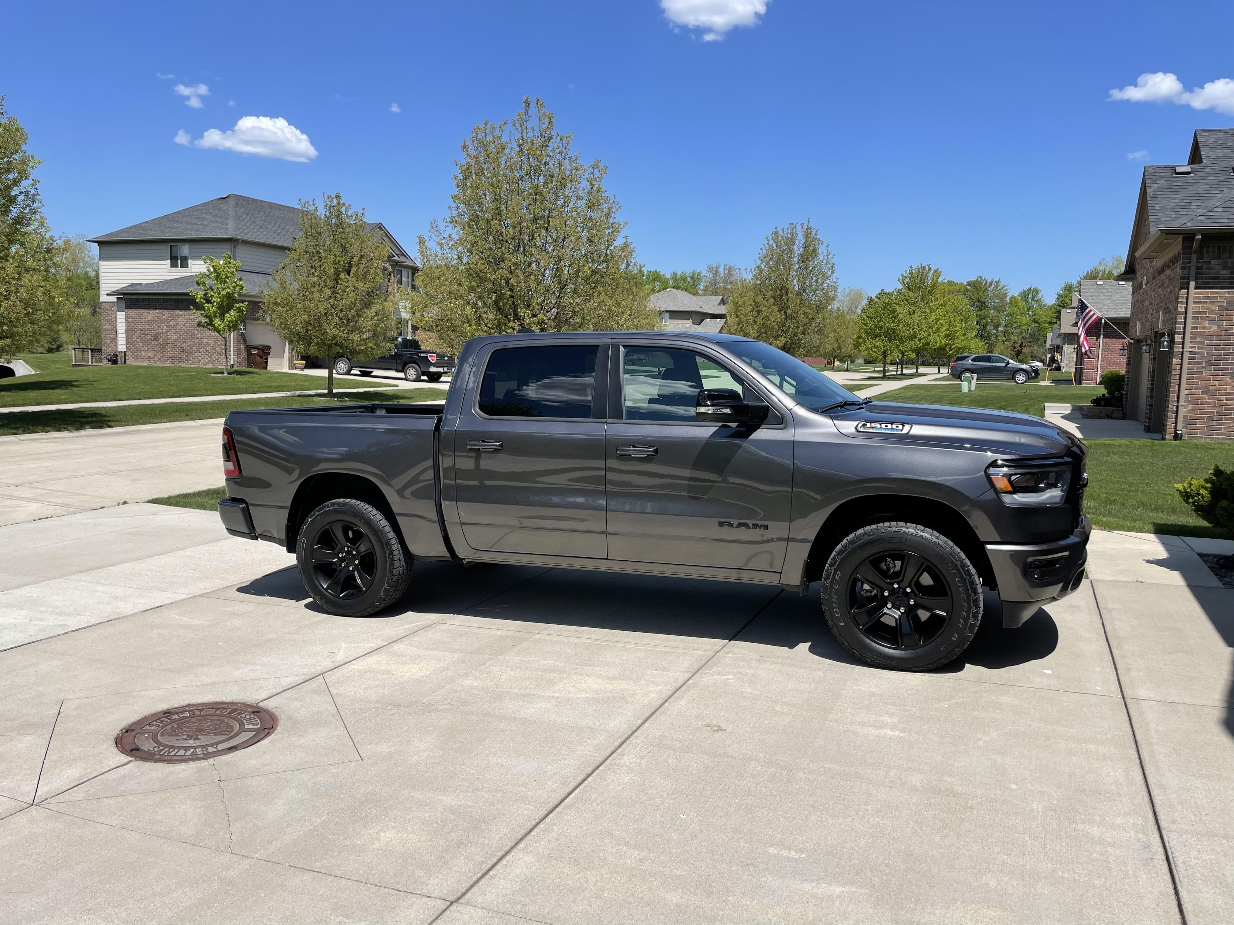

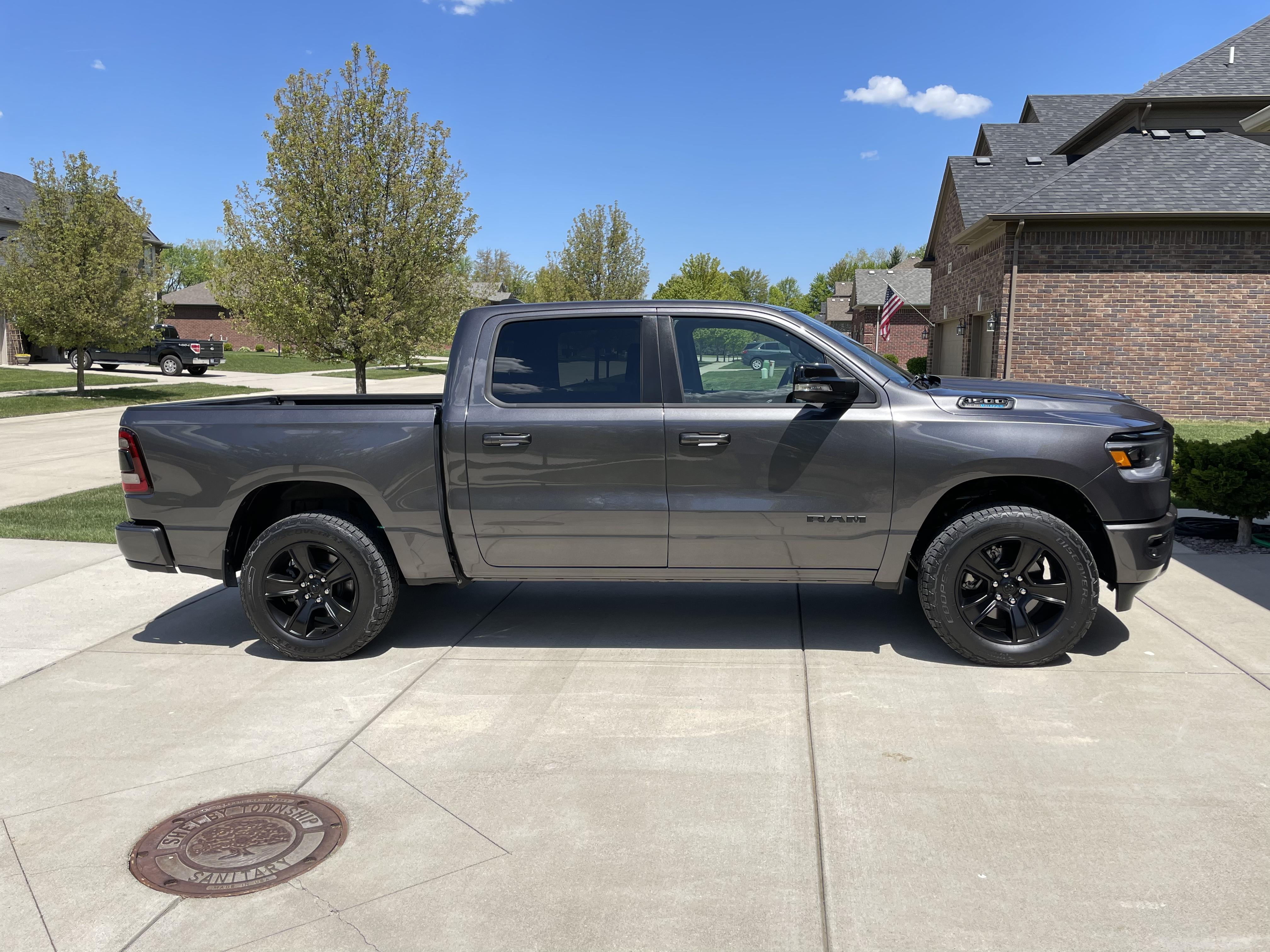

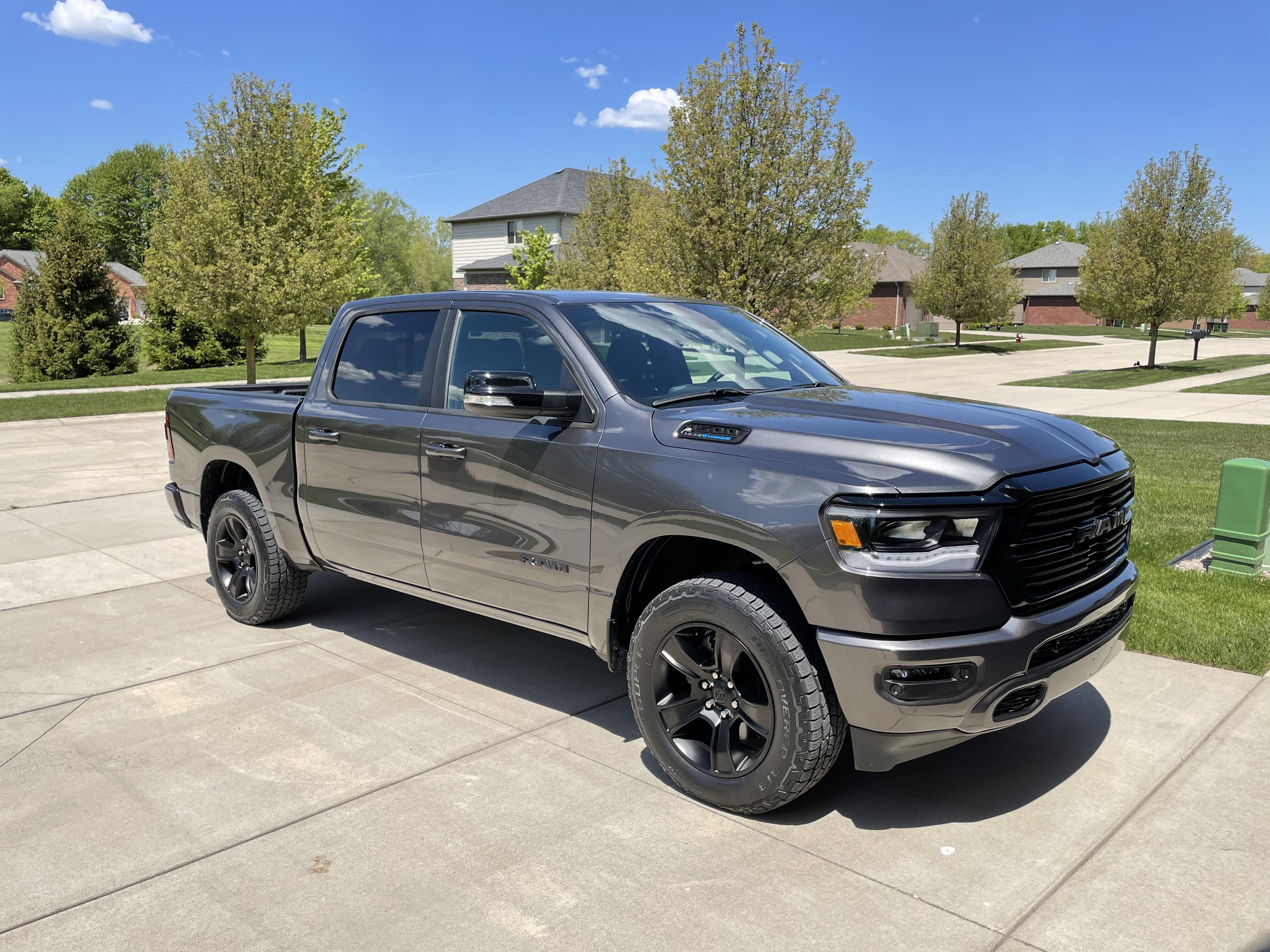

This is my setup. 6112s on #7 with Zone UCAs riding on LT285/65R20s on stock wheels. I also removed my front air dam.
