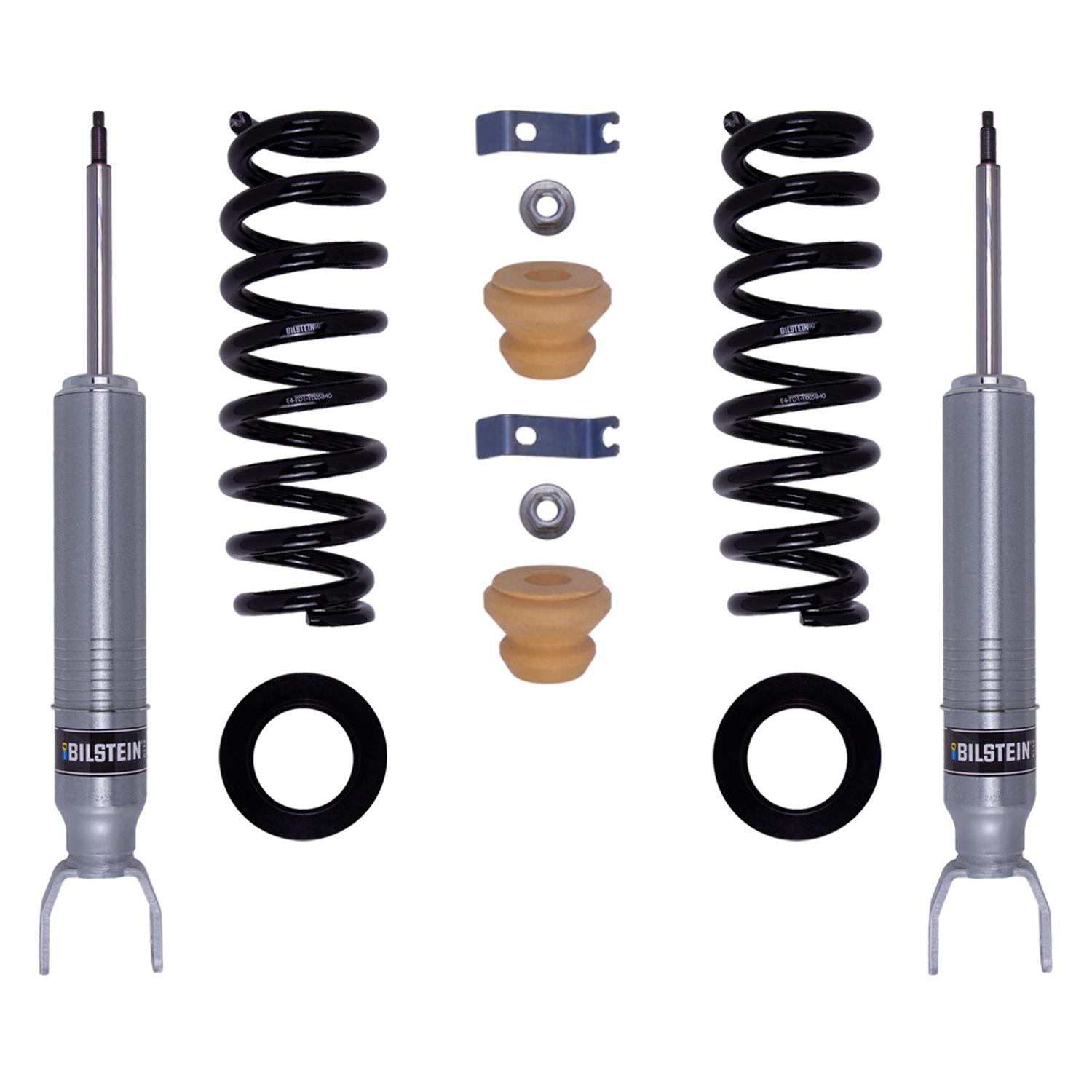

Any of you guys have done 6112's in the front ?
The part number I have for the 6112’s is bilstein 47-293540. Does anyone have the part number for the oem top mount for the strut assembly? I plan on assembling coilovers and replacing and selling my 5100’s as whole asemblies
It looks like 68329762AC. There are a few small parts on the OEM assembly that get re-used. I would look at the 6112 instructions and compare it to an OEM diagram like the one here https://www.mymoparparts.com/v-2020...suspension--front-suspension-strut-and-cradle to see what all you need. I legitimately thought about doing the same thing to make it more plug and play.

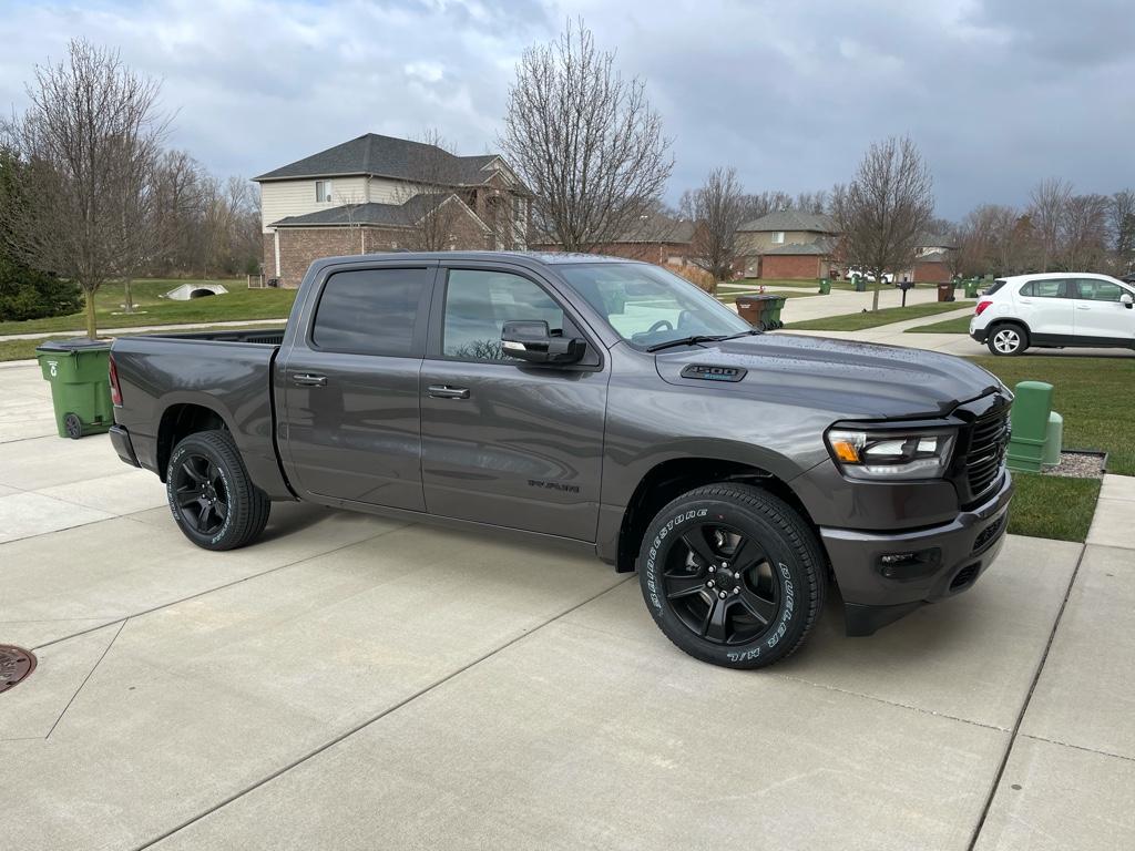

Got my 6112/5100’s on today. Went with setting number 7 and it was the right choice for me. Started at about 22” in the front, hub to fender, and currently sitting about 24 1/8. I had the off road springs installed in the rear and gained almost exactly an inch, going from 24” to 25”. So I’m left with a little less than an inch of rake. Very happy with the way it sits.
Haven’t driven far on them so far but initial impressions are good. Seems very smooth and still very factory-like. The technician that did the work had to come out to meet me when I picked the truck up because he loved the truck so much. He was even impressed with how it rode. I think I may have a tire slightly out of balance (just had them installed along with the Bilsteins and they came already mounted and balanced from an online retailer), but otherwise, so far so good.DDD61D03-08A0-4CC1-B2E8-7B701854C36D.jpeg263721C2-D15A-42A0-9EC3-32CBBBD27ED9.jpeg

What size tires are those

If you don't mind can you send a picture of how your truck looks now?
