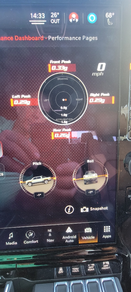

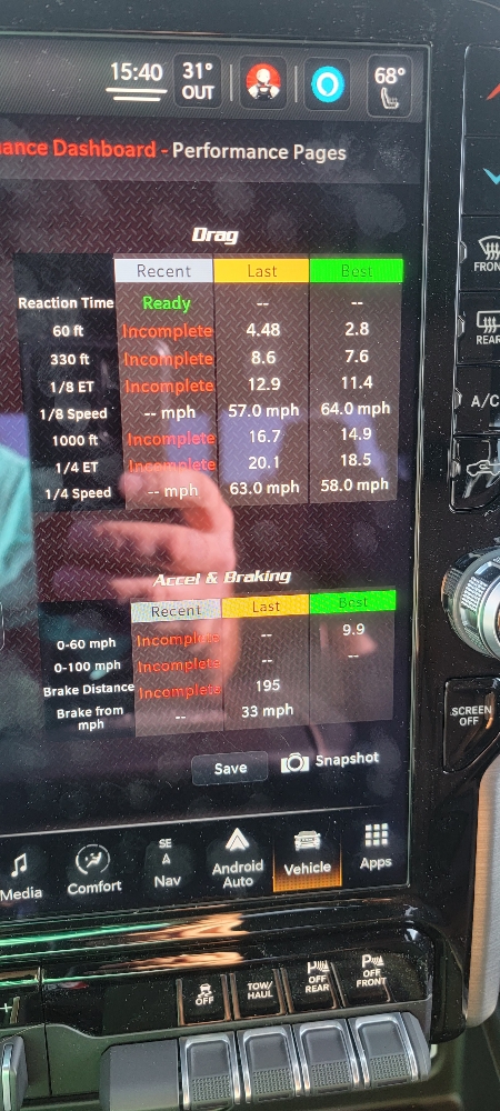

I activated my performance and offroad pages today, and was pleasantly surprised at how easy it was. I've read most of this thread, which is probably why it went well. I wasn't expecting all the features to work, but almost everything does!!! I didn't think my truck would have accelerometers, inclinometers, or timers, but it apparently does. The only think so far that isn't working is the oil temp guage on the off-road page, but it works fine on the performance page. If this is already known to be working on the 22 models, sorry for making a big deal about it, but I haven't seen anyone post about it. Attaching some pics to prove I'm not delusional - and yes I'm aware that my 0-60 time won't impress anyone!
My truck is stock, other than the 3 Alpha OBD settings to enable the pages.
