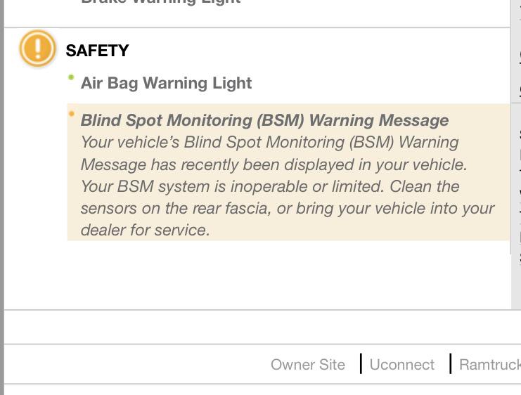

Wondering if anyone knows which module to connect to for the blind spot monitoring? Having an issue where I keep getting vehicle health reports of issues with the BSM, wanted to look into it but can find it anywhere in Alfa.
You would connect to object detection in the list of modules. You can only connect to those if you have an MX+ or EX interface.
Thanks Jimmy, will go have a look. I have the MX+.
