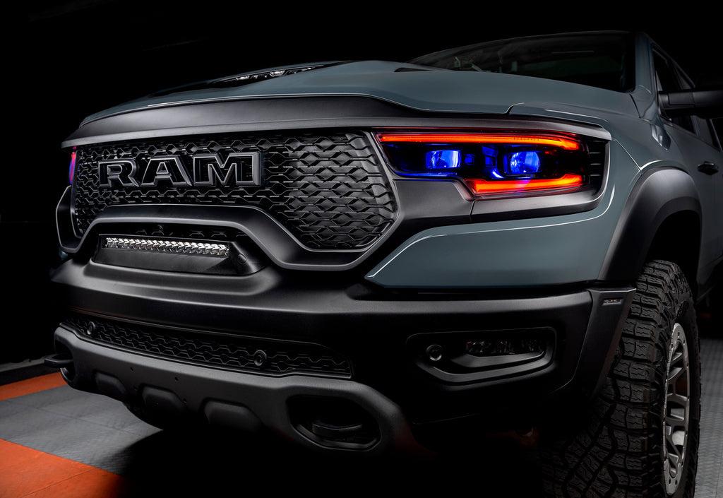

I ordered a set of the Oracle accents and threw in a set of the demon eyes since I was gonna have the housings open anyways. $387 for everything including the BT controller and a tube of silicone to seal them back up with.
So stoked for these!
I’m thinking of adding the Iracle Demon eyes how are yours holding up after a year?
There was an issue with them fulfilling my order so I ended up cancelling it within a few days of placing it.
I also chickened out of splitting my headlights open.
Diode Dynamics makes a universal kit that will fit in My rebels headlights with a slight alteration to the kit. Found a couple installers bt me that are DD authorized
