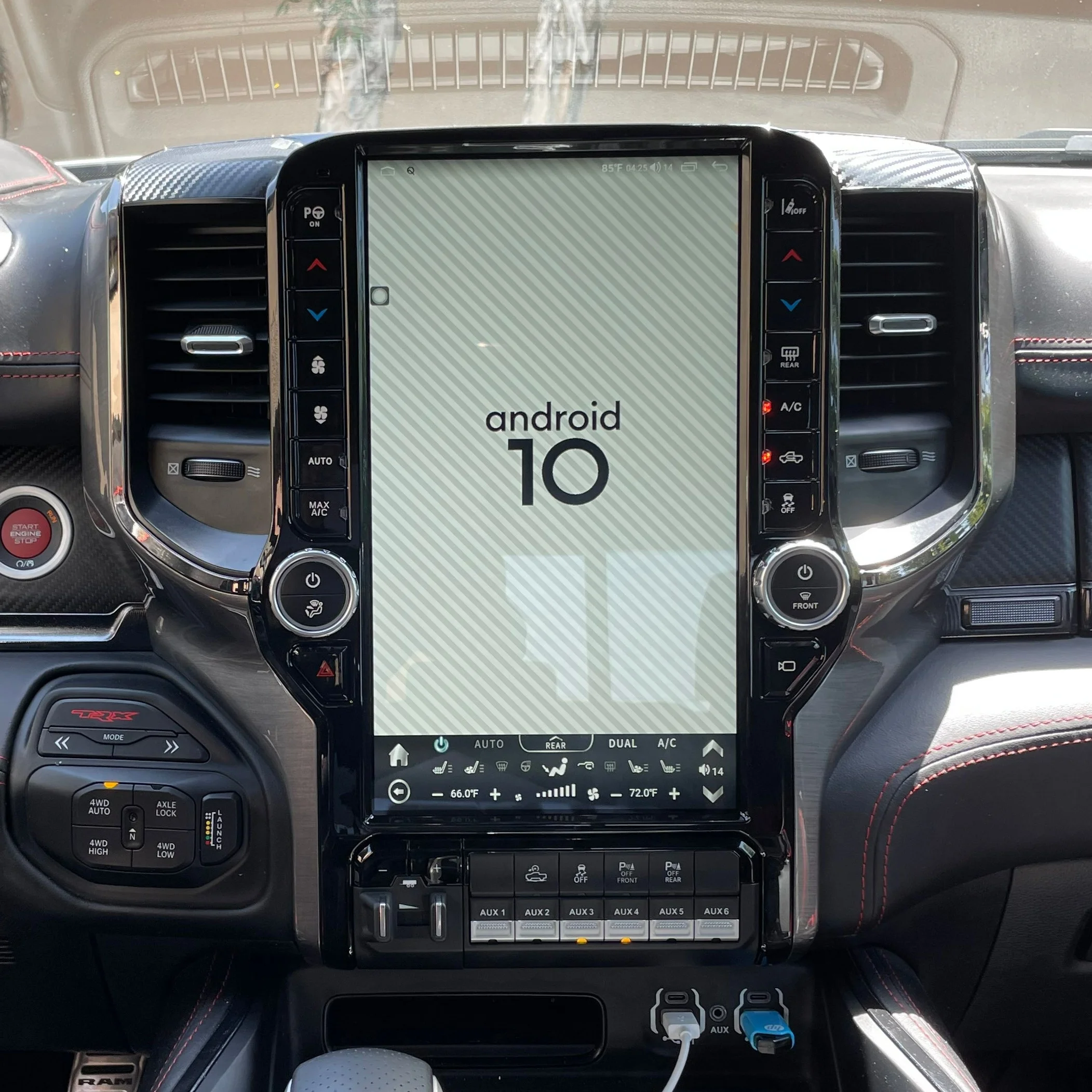

*1ST UPDATE AFTER INSTALL** Got my Phoenix 13.6" radio yesterday, and honestly for the price, my expectations aren't that high (It was $760). Shipping took about 10 days from date of order from their website). Initial feelings tho, I am feeling a tad disappointed, and not sure (so far) if I am keeping it. I have the base 8.4 which sucks, but works. Since there is a lack of information on this thing, and real world use, I am going to try to provide some. If any of you own this radio, and can help, chime in.
A few things.
1. Install was easy. All you have to do is follow the tutorial on Phoenix's YouTube. You will need to move your vents and module at bottom near HVAC over to the new radio. Pretty straightforward. The most difficult part was getting the freakin cigarette lighter out the dash (thankfully found a youtube video)
2. I knew the backup camera quality wasn't too hot. Well, no surprise there, it isn't. Especially at night. Even going into the dev options (code 3368), and choosing the higher quality mode, it still sucks. Potential deal breaker!
3. FM quality is DEPLORABLE. My antenna is plugged in. The pin is straight and not bent. There is so much static. I switched the FM ALWAYS ON setting to "ON" in the dev settings. You would think you were in the middle of nowhere. The reception is TERRIBLE in places I listen to FM radio all the time WITH THE FACTORY RADIO. Another potential deal breaker for me.
4. My subwoofer will not work with this radio. It doesn't even receive power. I use a Pacsub Audio interface (APSUB-CH41), that is connected to the radio thru a harness. Works perfect with factory radio. The interface just blinks with this radio and doesn't negotiate a signal. I thought maybe I pulled a remote wire or something by mistake, so I plugged up the old radio, and the amp/sub fired right up. After re-connecting the factory radio, I can them uplug it while the vehicle still has power, then plug up the Phoenix, and in THAT case, the interface still pushes the "on" signal to the amp/sub. However, once the truck is restarted, it's back to not sending a signal to the sub. I have no clue where to even start to fix this. I went thru the settings on the radio to turn on "amplifier", but it does nothing. Could I pull the interface, and just tap the rear speakers? Sure. But, alot of us with systems prefer to use Pac Interfaces because it avoids splicing, and it sends such a clean signal. THIS IS A MAJOR DEALBREAKER FOR ME
4. I was under the assumption from reading that Apple CarPlay works fine. Yeah well. Not the case. I know this is an Android radio, and I know ideally you want to use an Android phone. Now, I didnt buy any of the extra dongles because from other users comments, it wasn't necessary. Wireless Car Play connects when it wants (it uses some dinky android connect app) When it connects, it works great wirelessly. However, it's not reliable enough to trust. You can use Carplay or Android Auto with the included USB cable without issue.
5. Be sure to remove BOTH screen protectors. The display looks DISGUSTING until you do. Once you remove the second matte screen protector, the screen lights up like a christmas tree and has amazing contrast
6. I was not sold on this radio providing "better sound" than the factory system upon initial install. In fact, it sounded AWFUL. The audio was noisy, the speakers clipped super easy, and no EQ settings helped (Stock uconnect with an alpine sounds amazing in comparison). I found however, when connecting thru the "Bluetooth" app, that the audio sucked. Carplay sounds AMAZING (EVEN WIRELESS), and yes, once I got Carplay dialed in with EQ, this radio def rocks the factory speakers.
7. All of the factory stuff works fine. All of the steering controls, HVAC, etc. No issues there. Even Auto HVAC (my truck was already equipped with it)
8. It's def an Android Radio. Don't buy this radio expecting it to be an amazing out of the box experience. It takes some tweaking to get it to a fun, useable state. For sure get car launcher pro, because the default launcher is UGLY and it sucks. It's relatively smooth. There are some glitches here and there.
9. My truck was not equipped with GPS, so my GPS comes from Carplay. I cant comment on how accurate real GPS is with this radio.
10. To be fair, I love the way the radio looks. My friend has the factory 12" screen in his ram, and honestly once the screen protector is removed, it looks every bit as OEM as the real OEM 12" radios. The bezels they make are really nice and on par with the construction of the Uconnect 12" bezels. I felt the screen looked cheap and washed out, until the second screen protector was removed. The brightness is decent also.
All in all. For $750, we cant be TOO critical of it. But there are def some dealbreakers for me, mainly FM radio quality (I use FM alot still, and remember satellite radio is not an option on the Phoenix), and the biggest one, the fact that this radio doesn't jive with my subwoofer interface. I am hoping someone has a solution for this. The fact that the radio will hold the signal until the power turns off when the factory radio is connected, tells me, there's some type of incompatibility, or some dev setting that needs to be changed. I hope this write up is helpful!
By the way, this is the 6GB/128GB SSD variant. I chose silver trim, black knobs. I have not installed any media on the unit yet, and you can of course install any app that you would be able to install on an android tablet, on this radio. You just need an internet connection. So you can install the spotify app, YouTube app, etc., and they will all run native as long as you have a data sim card in, or have hotspot from your phone324296663_3238539953065607_1659961429506672212_n-2.jpg324021003_1240637126533559_7071611587553412576_n.jpg324445133_740465661046127_152676739722655922_n.jpg324292679_732001474718178_4565496442374074300_n.jpg324296663_3238539953065607_1659961429506672212_n.jpg

**UPDATE**
My radio has been strangely keeping up with the time now, and I did not put my SIM card in. Maybe it finally picked up from CarPlay? Strange, because that would be the only place it could get it from. Other than that, besides the typical little android quirks here and there, nothing has changed since my last update. Radio is working great, wireless CarPlay connects 8 out of 10 times right away, which is better than alot of aftermarket adaptors. Sorry I have not tested the brake release yet. The audio system sounds FANTASTIC once you get the EQ dialed in. (remember, dont use the built in bluetooth menu, the audio bitrate thru there is TERRIBLE).
Everyone who gets in my truck cant believe how amazing the screen looks. Even my friend with a ram with the 12" Uconnect said "man your screen seems so much bigger".
Popping my SIM card in tomorrow just to be able to use the apps without my phone connected, such as Youtube and all that stuff. The mobile hotspot from t-mobile phones just doesn't provide enough bandwidth around here to play any of the apps with good quality.
Again, for the money, once the quirks are figured out, you accept that FM radio sucks (I just use XM thru CarPlay instead), and the backup cam sucks - but useable, once CarPlay starts connecting reliably (seems to take a day or two to settle in, I recommend snaking the USB cable from the back of the radio down into your storage area for those times you need to connect the phone and use wired CarPlay when wireless wont work), once Car Launcher Pro is set up (very easy) and your EQ is set up nice on it, its a WIN, for $700!! I stress this again, I dont think I would keep the radio if it wasn't for CarPlay. But because we do have android auto and CarPlay, it is an AMAZING radio for those things, and looks cool as hell on top of that.
By the way, I purchased thru 13.6” Android 10 Vertical Screen Navigation Radio for Dodge Ram 2019- 2022
