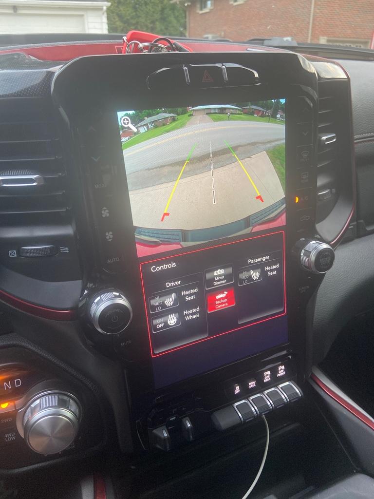

EDIT: I just went back out after about 40 minutes. I turned the truck on and the screen is black. If I put the truck into reverse the screen comes on. When I put the truck back in park the screen goes off. Radio works and so does the volume knob even while screen is black. I’m lost and incredibly frustrated.
EDIT 2: I checked the BCM for a third time and it is correct. I pulled the negative batter terminal this time for 10 minutes. Hooked it back up and the screen will power on. I let it set an hour and came back and the screen will not power on. It is back to only coming on when I put it in reverse with the backup camera showing but goes off as soon as I go into any other gear. Again radio works and all the buttons on the side of screen work, tune, volume, mute, power (turns off the sound only since the screen is already off).

2021 module came today and everything works! So that was definitely the issue with the camera. Took about 2 hours for everything to pull through.
