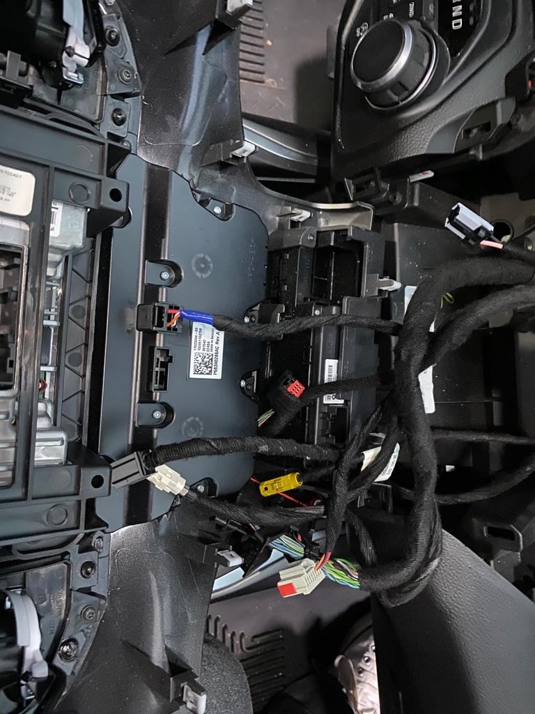

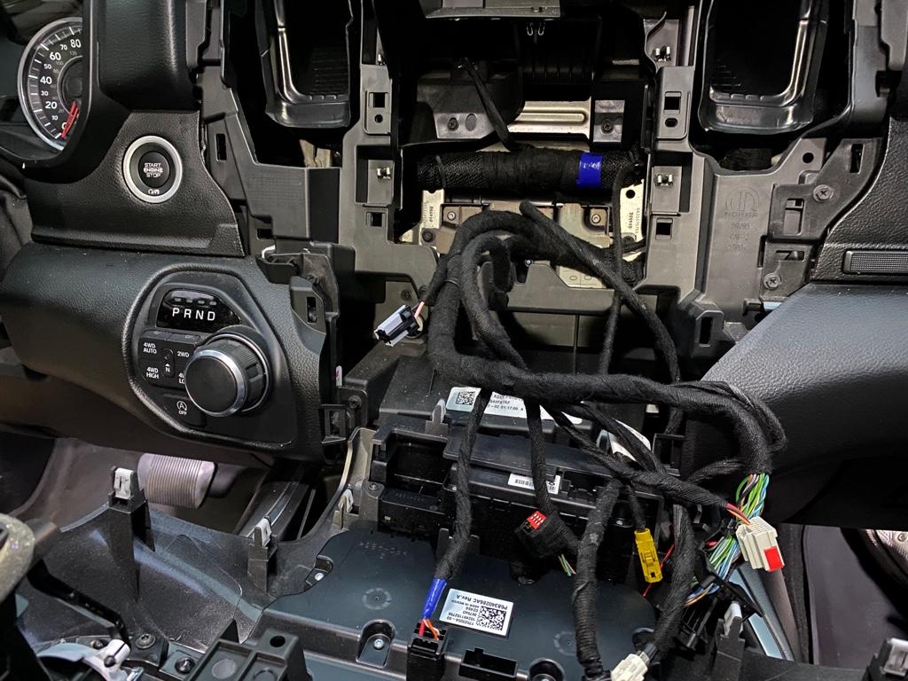

everything in now my cable got here today will be doing this tomorrow hopefully....Only issue don't know a lot about repining a harness......

Repining the harness is the easiest part..
Is there a pic somewhere that i could use as a reference
Pry the red face off of the connector. Then insert a paper clip in the front underneath the terminal to pry up the plastic terminal lock. You’ll push in on the wire while prying up the plastic locking tab, then pull on the wire once the tab has cleared the terminal.

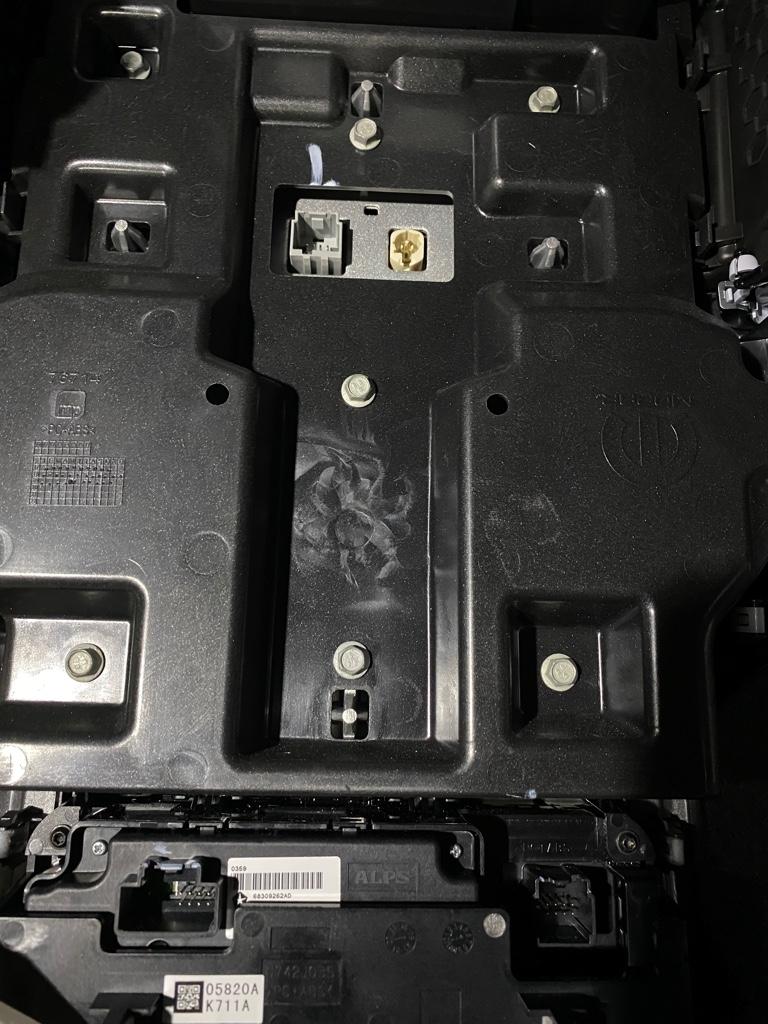

Have a couple of questions I’m coming from non nav 8.4 ok I am posting a pic of the back of the 12 in screen that’s going in and my existing wires my existing wires which one needs repinned and two I can find what hooks into the grey connector behind the 12 inch screen. Also, I’m assuming I’m going to need to find mounting hardware for the new module because my module for my 8.4 is mounted to the whole screen unit this unit came with brake controller is that something I will have to get later because I don’t think my truck came pre wires
I circled the plug for the Brake controller, It's already there. You do need to get the TBC module but it's pre-wired.2ea988c8df7e476c956abd650a38f8c4.jpg
You can use zip ties...
