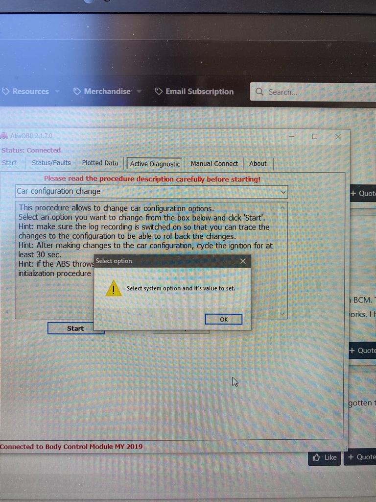

Same result man
I’m not even sure if it’s the Bluetooth interface because usually it fails when actually trying to make the setting change. I’ve never come across that screen before. You might have to send that screenshot to Alexey, the developer, and see what he says.Same result man
[email protected]How do I contact him?
Probably not because the interface connects. You could verify by plugging the interface in without the bypass. You should still be able to get into car configuration change without the bypass.Could my by-pass be connected wrong or something?
Alright, so apparently there was another windows update for AlfaOBD yesterday, and that is what broke the program. Everything else you were doing is correct, it’s just the AlfaOBD software itself. He’s aware and working on it. Only other option is if you have an Android device, you could get the app.Ok I’ll let you know how it goes in a few, I’m highly aggravated so I’m taking a break, if this don’t work I’m just taking it to a car audio shop tomorrow.
I’m not trying to pay another $50 for the app license man If you email him, he will set you up with the Android version apk for free (if you have an Android device).Are you serious?????I’m not trying to pay another $50 for the app license man
No, he means the Android version and not the PC version. We got it to work programming it from my cell phone using the Android version of AlfaOBD.@irobbi, the trial version will do it?
New windows version with the fix just released. New version is 2.1.8.0. Broken version was 2.1.7.0The trial version doesn’t work, asks you to pay...I just tried it. Still waiting on an email back with a license code
